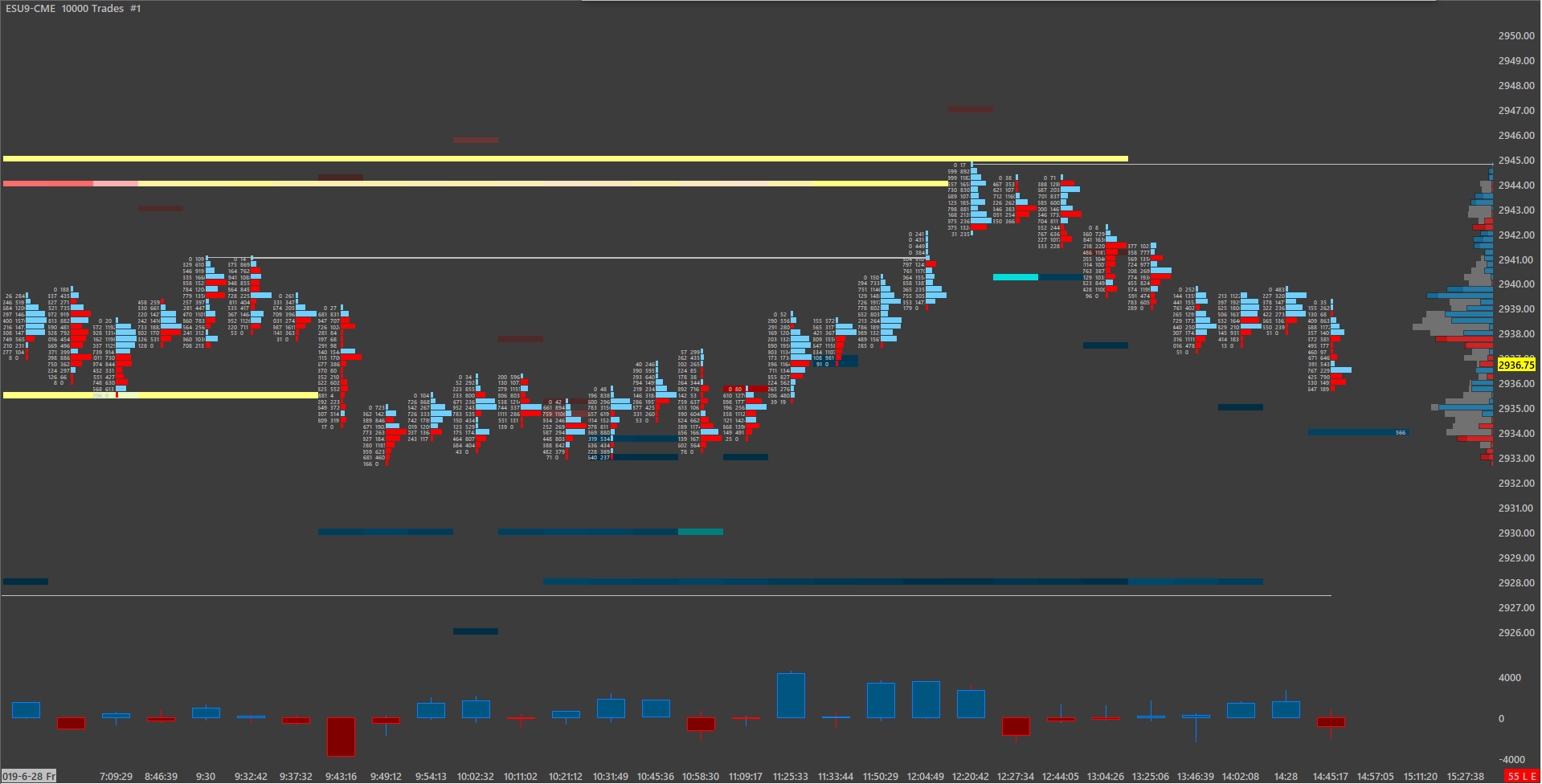

Hello Can you please direct me on how I can get my range charts to show the delta between each price level? I've attached a picture of how it looks like..The red/light bluish.

You will want to use the Numbers Bars study.
There are a few different ways that you can do this, but the easiest would be to use the 2nd column in the Numbers Bars study. In the Input for Column 2 Background Type, set it to Ask Bid Difference Profile. You have a few options on how you want to see the coloring for the bars, but if you are more interested in which side is dominant, then set the Input for Column 2 Background Coloring Method to Based on Dominant Side AskVol BidVol Percentage.

It sounds like you want to do diagonal comparisons between the price levels in a Numbers Bar. For instructions, refer to:
Numbers Bars: Diagonal Comparison of Bid Volume and Ask Volume

[2019-08-08 00:59:46]
Chris_uk - Posts: 89
As per our DM, the cht file is attached.
This is what it looks like:
http://www.sierrachart.com/image.php?Image=156522589985.png
Cheers
attachmentvolume footprint with depth.Cht - Attached On 2019-08-08 00:56:26 UTC - Size: 118.08 KB - 1404 views

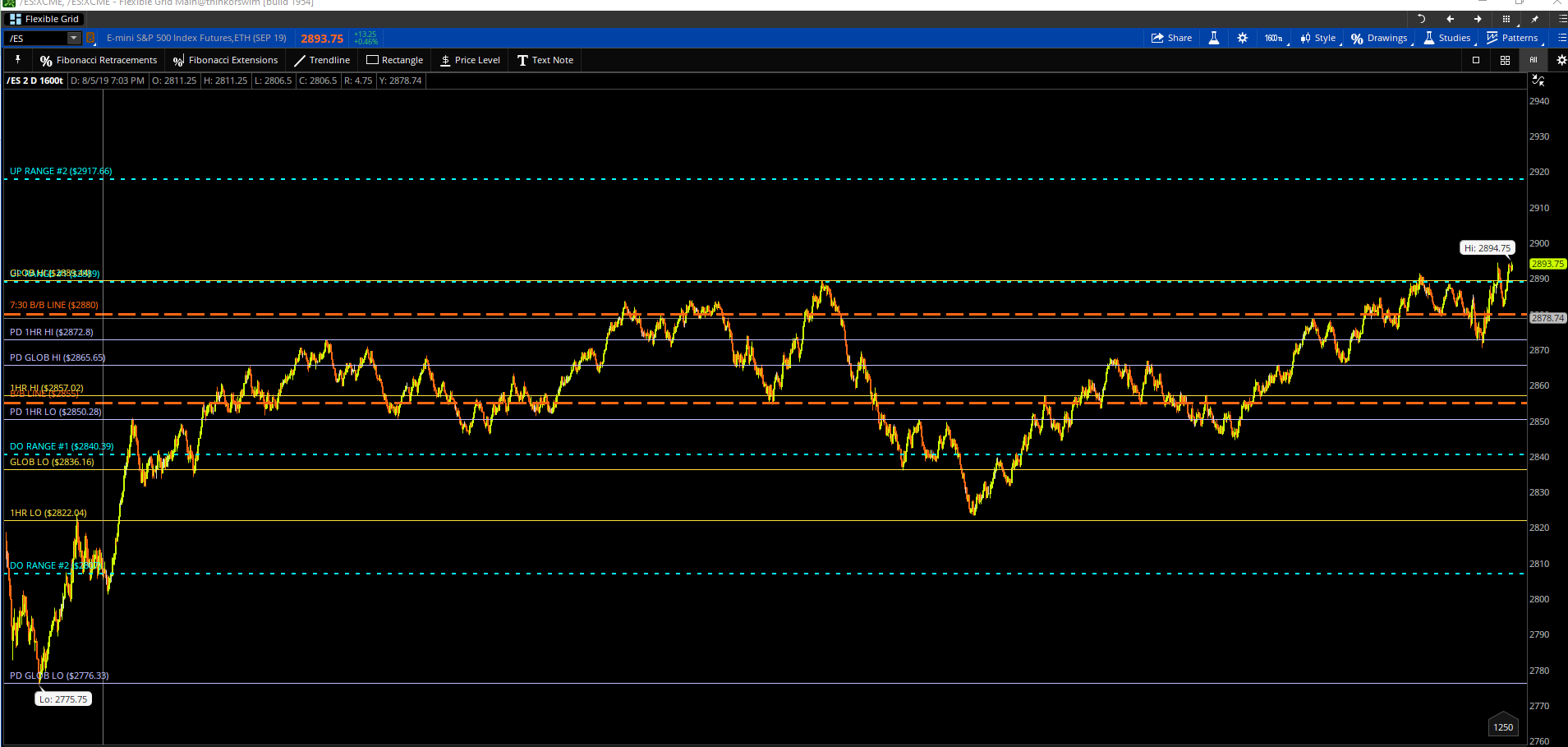

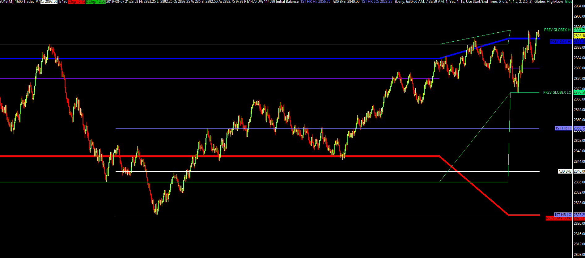

[2019-08-08 04:25:39]
Oxcap - Posts: 81
This is what I'm referring to Chris.. two attachments here..one in my TOS and one SC that I'm working on.
imageIntraday levels.PNG / V - Attached On 2019-08-08 04:24:56 UTC - Size: 108.18 KB - 701 views
imageIntraday SC needs work.PNG / V - Attached On 2019-08-08 04:25:02 UTC - Size: 76.79 KB - 651 views
[2019-08-08 15:12:29]
As per DM, plz find attached .cht file
attachmentLevels.Cht - Attached On 2019-08-08 15:12:21 UTC - Size: 58.37 KB - 788 views
