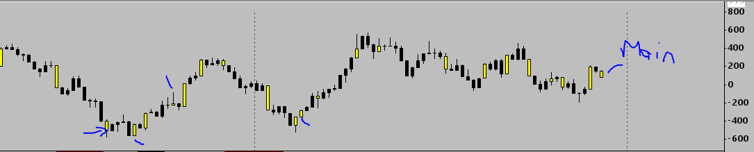

I have an ATR on a CumDelta-Volume study.
I put a color bar base on alert condition on it that looks like this
=(ID1.SG1[0])>=((ID1.SG1[1])*1.6)
But , It always paint the main bar at the start and sometimes keep the paint on when It does not need to after the bar close.
I am using a Tick chart.
Am I doing something wrong , I look at the Calculation order but this does not seem to fix anything.
thanks
imagethis example.PNG / V - Attached On 2021-12-31 15:47:36 UTC - Size: 13.37 KB - 369 views

GravisHTG - Posts: 321
I am trying to paint the bar only when the current bar is *1.6 times greater than the last bar.
what happen is that , On new bar , it always paint the bar even if it go 0 Range.
And sometimes the painting is still on even if that requirement is not True.
did I did my alert wrongly ?
With my settings , the bar is not suppose to unpaint after it is paint as , the bar will always keep the same RANGE.
That calculation come from an ATR , base 1 , simple MA on a Cummulative Delta - volume. And I use a Tick chart.
Date Time Of Last Edit: 2021-12-31 18:26:01
[2021-12-31 19:12:58]
So ID1 is the Average True Range study?
It looks like your main issue is the use of a '1' instead of a '-1'. If you are trying to compare the current bar against the previous bar, then your Alert Condition should be the following:
=(ID1.SG1[0])>=((ID1.SG1[-1])*1.6)
Then if you want the bar to paint when true and then to not paint any following bars, you need to enable the alert option for Reset Alert Condition on New Bar. The condition you have should reset without this option, but best to enable this as well just to ensure that you do not miss any odd situations.
