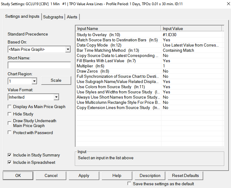

Sorry, we forgot one important item. You need to set the Study/Price Overlay Input for Bar Time Matching Method to Containing Match. This will then use the last data point forward through the evening session until the next data point is available from the other chart.
[2019-08-06 22:16:42]
User161560 - Posts: 19

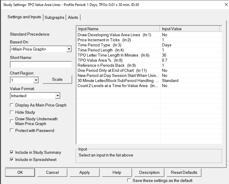

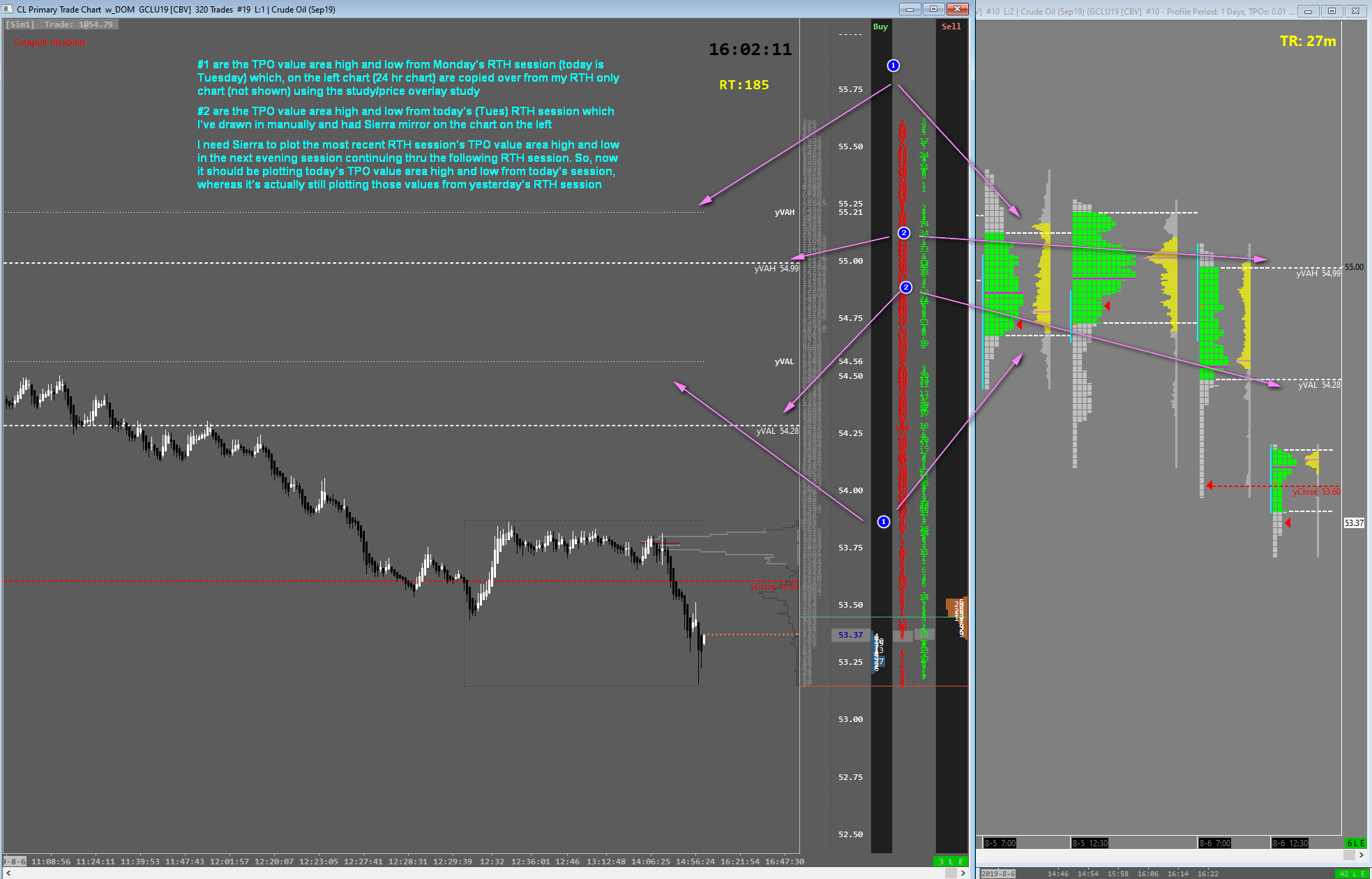

Thanks John. I changed that setting but I'm afraid it's still not plotting the last RTH session's TPO value area high and low through the following evening session. I've attached my settings for the two studies and an annotated chart illustrating the issue. Any further ideas greatly appreciated!
Cheers
Simon
imageTPO Value Area Issue.png / V - Attached On 2019-08-06 22:15:26 UTC - Size: 175.19 KB - 951 views
imageStudy Price Overlay Settings.png / V - Attached On 2019-08-06 22:15:30 UTC - Size: 28.04 KB - 633 views
imageTPO VA Lines Settings.png / V - Attached On 2019-08-06 22:15:34 UTC - Size: 23.98 KB - 579 views

Ok, we understand what you are looking for and how what we suggested was not quite right. We have to think about how to accomplish what you want.
[2019-08-09 22:34:58]
John - SC Support - Posts: 48548
The only way we can think to do this would be to add the Spreadsheet Study into the mix. Here is what you need to do:
- Set the TPO Value Areas Lines input for Reference n Periods Back to 0.
- Hide the Study/Price Overlay study, which should now be showing the current days TPOs.
- Add the Spreadsheet Study.
- Put a formula similar to the following into cell K3.
=IF(OR(FRACTIME(A3) > TIME(13, 30, 00), FRACTIME(A3) < TIME(07, 59, 59)), AB3, AB31)
You will have to adjust the times to match your chart, where the times inside the OR, are the evening session times. Also note that cell AB31 in the above is where the day session starts. You will need to adjust it for your particular chart.
[2019-08-22 22:35:43]
We are going to add a new Input to the TPO Value Area Lines study for it to support being based on only the day session times or regular trading hours.
In this way, you do not need any other additional studies or charts. It becomes very simple to use for what you want.
