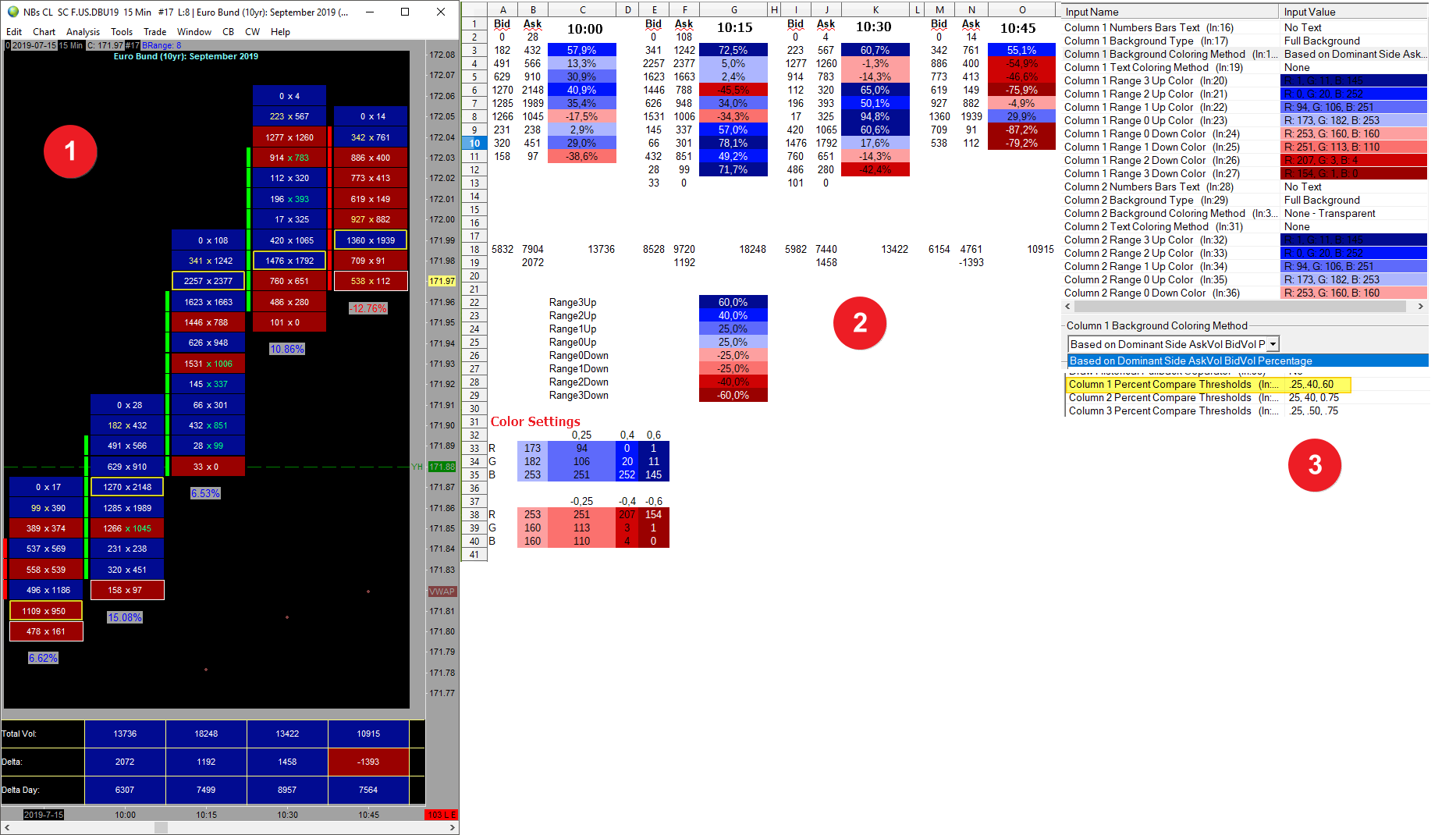

I am about to change my method from volume based on "Based Dominant Side AskVol to BidVol Percentage".
From my point of view, the result is displayed wrong(see #1)
My values are: 25%, 40% and 60% (see settings #3)
To get the correct representation, I have displayed the values in Excel (#2).
Is it possible that the values are calculated wrong or is it me?
Furthermore, I noticed that zero values are calculated. From my point of view in this case you should always use Range 0 colors.
(version: 1968)
Pls see pic.
Many txs.

[2019-08-04 18:01:35]
User907968 - Posts: 886
Your calculation method in excel is not consistent with the documentation, see link -
Numbers Bars: Background Coloring Based on Dominant AskVol BidVol To Volume At Price Percentage
It does not make sense to use values less than 1 (100%), as based on how the study is calculated (percent relative to each other), the dominant side (if there is one) will always have a value greater than 1 (100%), as to be dominant it must be greater than 100% of the non-dominant side.
e.g.
Bid = 100 Ask = 200
Bid % = Bid / Ask
Ask % = Ask / Bid
Bid % = 0.5 (50%)
Ask % = 2.0 (200%)
Hope this helps.

[2019-08-06 07:07:12]
Sorry, it seems that somehow I posted a link to the wrong NB setting.....
I meant to link this one -
Numbers Bars: Background Coloring Based on Dominant Side AskVol BidVol Percentage
Maybe it makes better sense with the correct documentation?
Negative numbers in your spreadsheet are not what I was referring to, it was numbers with an absolute value less than 1 (100%).
In your SC screen shot, Range 3 coloring is always applied to the dominant side.
This is because the dominant is always more than 100% of non-dominant side.
I don't know what exactly you want to see in the NBs, but suggest you try 1.25, 1.4, 1.6 and see what the result is.

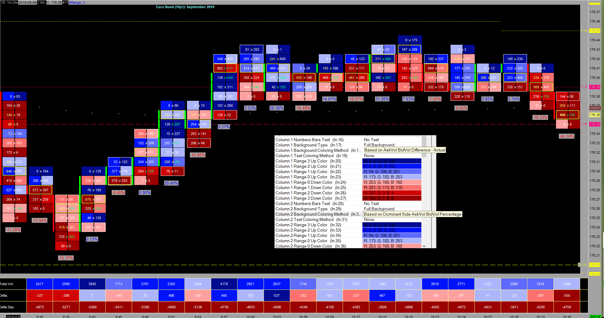

[2019-08-06 08:49:55]
nicktrader - Posts: 817
@ User907968
See pic. To test it under real conditions I opened a second Column.
imageNBs two Columns.png / V - Attached On 2019-08-06 08:47:29 UTC - Size: 140.68 KB - 432 views
