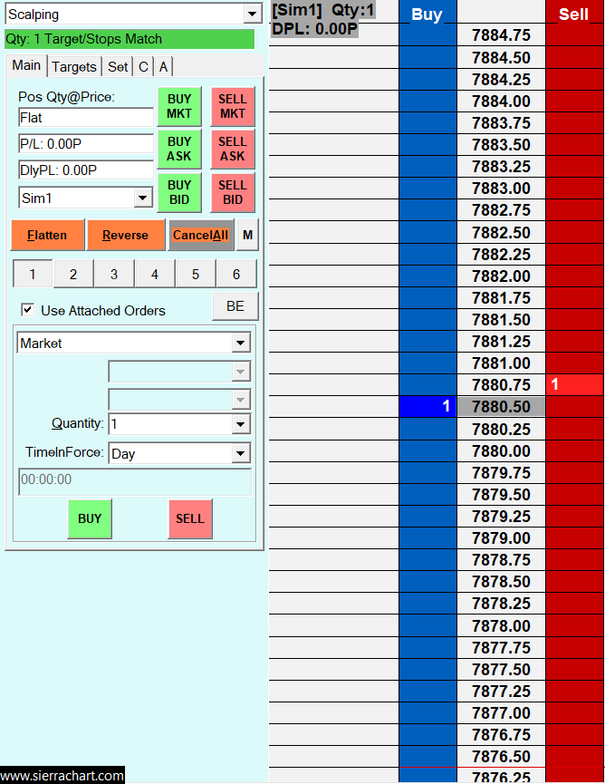

When doing market replay it only shows 1 on Volume and does not change , can you please check , using ENQU19 on market replay looks like volume no changing just moves up and down showing number 1 on bid and offer thx.
http://www.sierrachart.com/image.php?Image=15643556895.png
[2019-07-29 17:29:20]
This is because there is no historical market depth data recorded at that point in time. For instructions refer to:

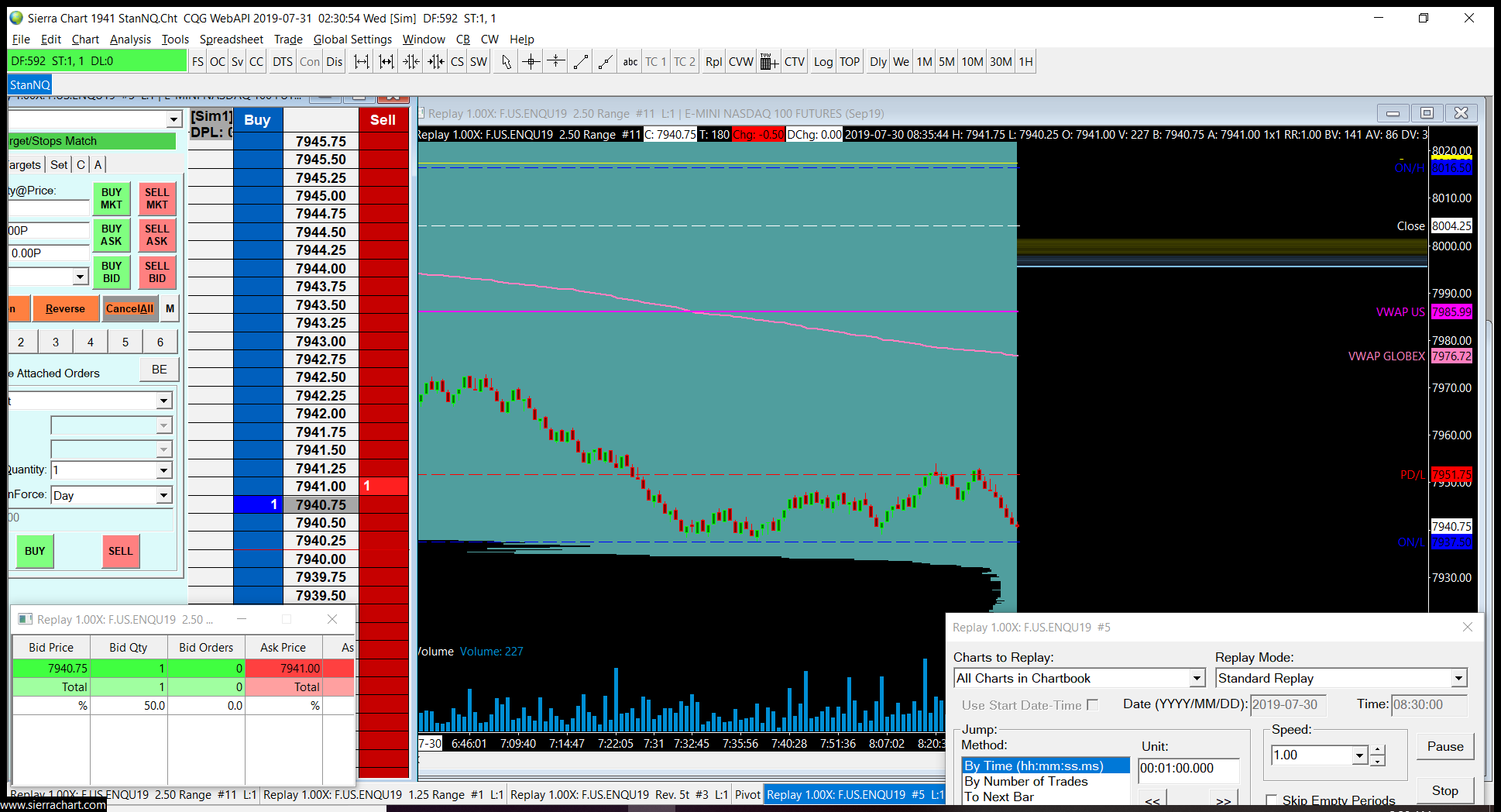

http://www.sierrachart.com/image.php?Image=1564554655615.png
Hey it does not fix my issue. Also, I would like to ask if the solution provided is offered for DOM? Only the volume on my DOM is inaccurate FYI, please look at my image. Any quick solution for this matter? This has been 3 weeks and I really need it fixed ASAP.
Just to let you know, I have the .depth file extension in \Data\MarketDepthData folder for the current symbol.
[2019-07-31 08:18:33]
This chart image is not helpful to us. Only add the Market Depth Historical Graph study to that chart and scroll back in time to where you are doing the replay. But do not replay that chart. And post an image of it.

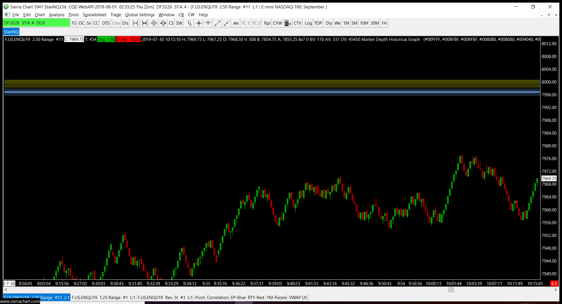

This is the image. It looks like the market depth historical graph is constant and showing zones from 7980 to 7984 only. Sorry for the constant late reply. I have to work 12 hours so I only have my night to research on this. I am also frustrated by this and hopefully this can be fixed soon, so I can start replaying chart and practice every night.
http://www.sierrachart.com/image.php?Image=1564641332651.png
[2019-08-01 19:19:05]
This is what we expected. What this tells us is that you were not connected to the Data Feed during that time, therefore there is no Market Depth data to display in the DOM. The fact that the Market Depth Historical Graph is constant and only showing a few levels is what tells us this.
The reason why it is showing a constant set of values is because it takes the last known values and extends them forward, but this indicates that there was no depth data recorded during that time. You can find more information on this topic here:
