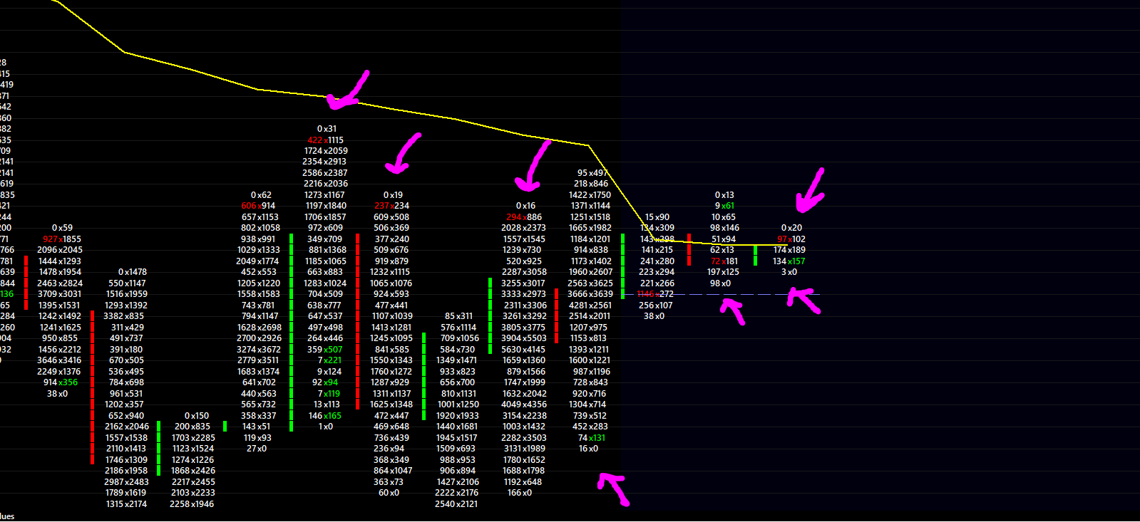

Is there a way to highlight 0 values (see image)? Currently the only functionality I can find ignores 0 values as shown below.
"When the Highlight Maximum/Minimum Value Based On Input is set to Bid Volume, Ask Volume, or Bid or Ask Volume, and there is a value of 0 within the bar for the particular volume type, then no highlight box will be drawn."
If it is by alert can you please write the formula for me as it is not my strong suit. If there is another way your help is appreciated.

There is a way to highlight the zeros using the Numbers Bars study by itself, but it may interfere with the other text coloring options you are using. You could also use another column just for this highlighting as well. Here is how to do it:
- Set the Column n Text Coloring Method to Based on Separate Ask Volume Bid Volume - Actual.
- Set the first two values in the Column n Actual Volume Compare Thresholds to 0,1. Set the third value as desired.
This will then color the zeros the Column n Range 0 Up/Down Colors.
