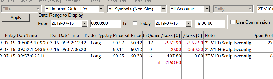

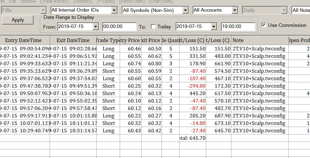

User993067 - Posts: 200
it means I cant sort by trade window configuration...notes sort ineffective..
This one days results..all same twcomfig...then sort by same in notes window...calculations way off...add up over a week and impossible to tell which tw config is most efficient.
imageCapture.PNG / V - Attached On 2019-07-19 23:09:17 UTC - Size: 61.82 KB - 462 views
imageCapture2.PNG / V - Attached On 2019-07-19 23:09:33 UTC - Size: 28.55 KB - 501 views
[2019-07-19 23:13:30]
only difference is that second screen is sorted by the same tw.config that was used the whole day...was +645 with out sort...when sorting...shows as -2168...whn using multiple tw configs...problem exacerbates
[2019-07-22 07:31:04]
You need to look at the first tab, the Trade Activity tab of the Trade >> Trade Activity Log and make sure the first fill is correct according to the explanation here:
Trade Activity Log: Open Quantity Field Calculation Method
And then make sure there are no missing order fills.
If there are missing order fills it may relate to the Text Tag/Note not being applied to the Attached Orders. This is now resolved in the latest prerelease 1954. Update following these instructions here:
But this does not affect existing recorded fills. Only going forward after the update.
If you have any trouble with live trading and missing fills, use this new service:
Sierra Chart Order Routing Service
Date Time Of Last Edit: 2019-07-22 07:31:36
