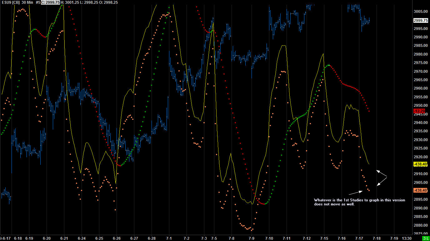

What ever is 1st on Studies to Graph does not adjust with the rest.

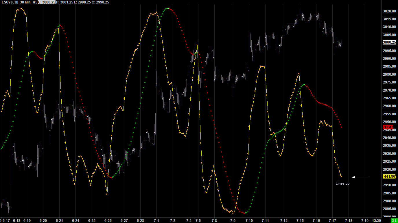

I am on version 1940. Whenever you adjust the chart whatever is
at the 1st Studies to Graph does not adjust with the rest.
Please see snapshots.
image1mmm.jpg / V - Attached On 2019-07-17 17:55:42 UTC - Size: 172.22 KB - 390 views
image1mmmm.jpg / V - Attached On 2019-07-17 17:55:49 UTC - Size: 181.74 KB - 469 views

This is just a Scaling issue. There are a couple of possibilities for what you are seeing. The most likely, given your statement about the first study, is that you have the Left Side Scales turned on. When this is on, the first appropriate study will use the left side scale instead of the one on the right with the rest. Refer to the following for this:
Chart Settings: Use Left Side Scale (Chart >> Chart Settings >> Scale menu)
The other possibility is simply that those studies are not using a Scaling setting of Automatic. Check each study and ensure that they are all set to Automatic (or if not, then be aware that they will not scale with the other items in the chart). Refer to the following for how to set the scale for a study:
Chart Scale and Scale Adjusting: Opening the Scale Settings Window For a Study
[2019-07-19 21:38:38]
We are looking into this because you cannot use an Automatic scale in the case you presented and if you are not using the Left Side Scale maybe the other graphs in Chart Region 1 should automatically adjust with an Interactive Scale Range/Move.
Date Time Of Last Edit: 2019-07-19 21:39:04
