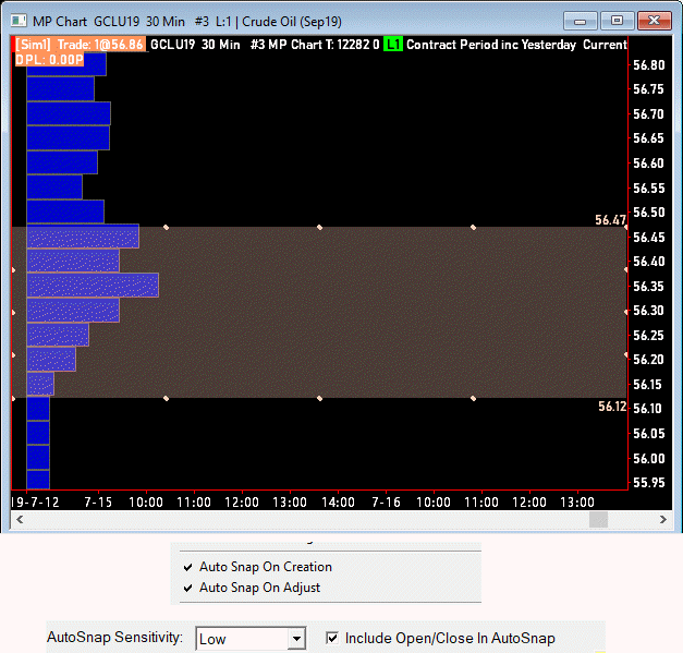

HinckleyBob - Posts: 45
My problem seems to be the opposite: I am unable to get the snap to tick price, at creation or adjustment. Setting and results are in the attached graphic image.Top line was adjusted, and should snap to 56.45, as I understand the description at page=doc/Tools.html#Snapping.
Thank you.
imagetick snap inop.gif / V - Attached On 2019-07-18 15:39:39 UTC - Size: 54.96 KB - 442 views
[2019-07-18 17:49:09]
John - SC Support - Posts: 48550
That symbol trades at a tick size of 0.01. Therefore, if you are using the standard tick size, then it is normal for you to have values such as what is shown in your image.
If you do have a different tick size, then let us know what value you have set.
