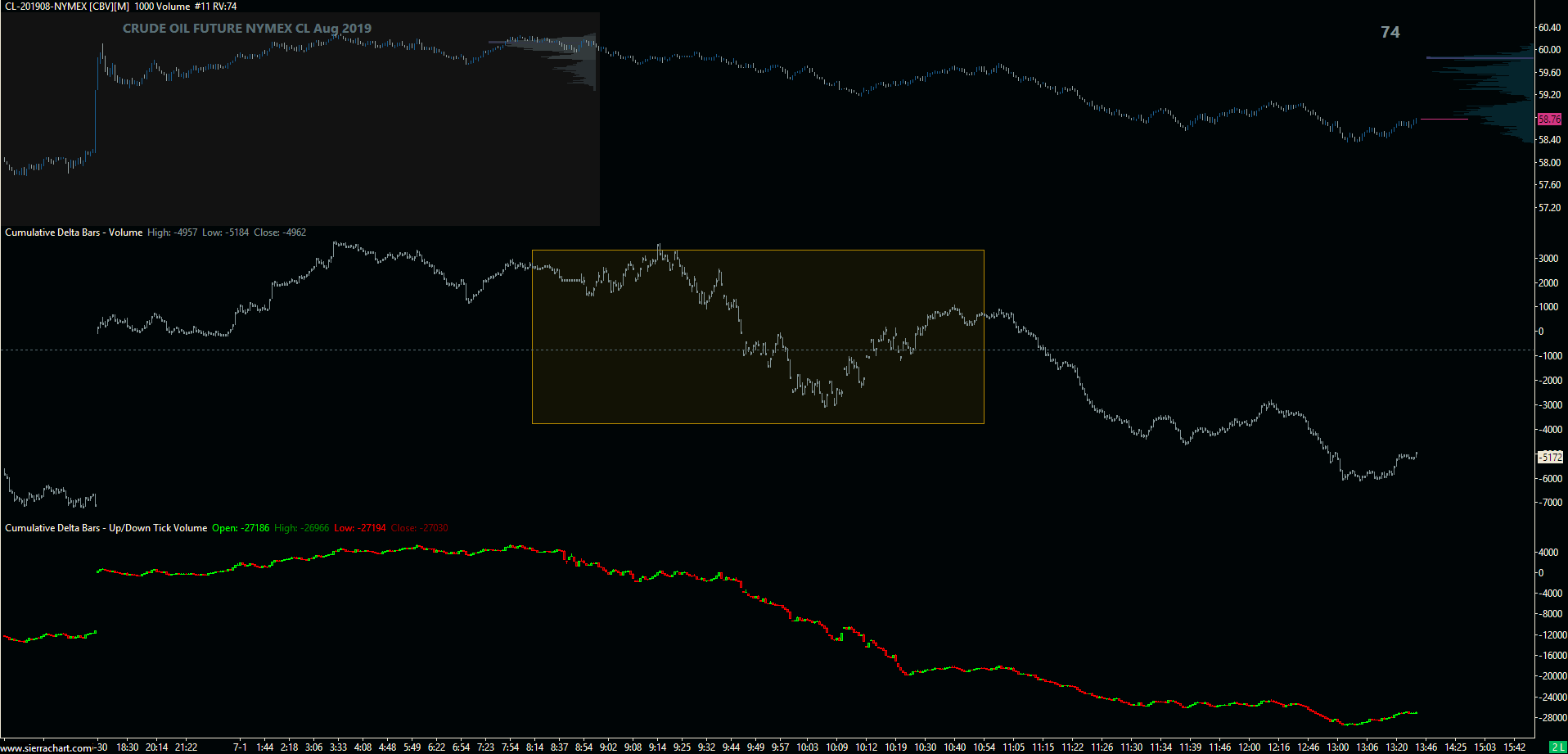

I subscribe to the Real-Time SC Data feed - I noticed this morning that on several of my charts (CL & ES) that the Cumulative Delta (Volume) had several gaps in it. Attempts to re-download data/restart/update to v1941 did not solve the issue. I did connect with another data source to confirm that the Cumulative Delta should not have gaps this morning.

This is what we see:
http://www.sierrachart.com/image.php?Image=1562001222482.png
With how that study is designed not sure why there would be gaps. We want you to add the Bid Volume versus Ask Volume study to that chart and then post another image of it.

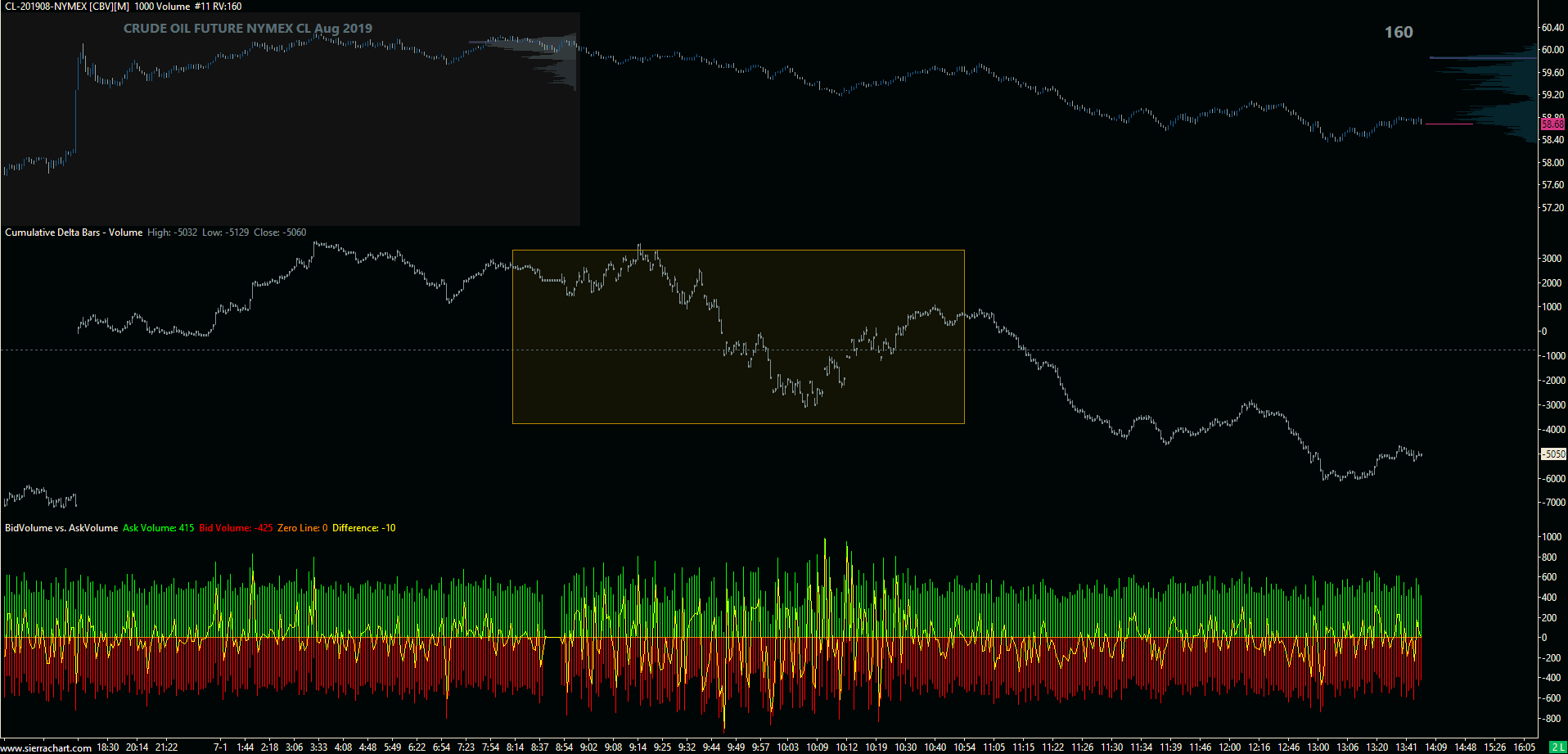

My apologies if I upload the incorrect study you requested - I did not see a Bid Volume vs Ask Volume study exactly, so I guessed you wanted Cumulative Delta Bars - Up/Down Tick Volume

No that is not the study we need. This is the one:
[2019-07-01 17:53:48]
User807771 - Posts: 12
Thank You - I did not initially look in the Custom Studies section. Updated image attached
http://www.sierrachart.com/image.php?Image=1562003516245.png
[2019-07-01 17:59:11]
You definitely have data and that chart that is not from the Sierra Chart Historical Data service.
Follow the instructions here to read download the data since the beginning of the day:
Data Errors or Spikes in Charts, Flat or Flat Line Graph, Compressed Graph, Errors with Date/Time Values: 2.1.2 Deleting and Re-downloading Data. (Easier and Recommended Method)
Additionally that study is in the main list of studies. It is also listed with custom studies but you did not have to go there.
