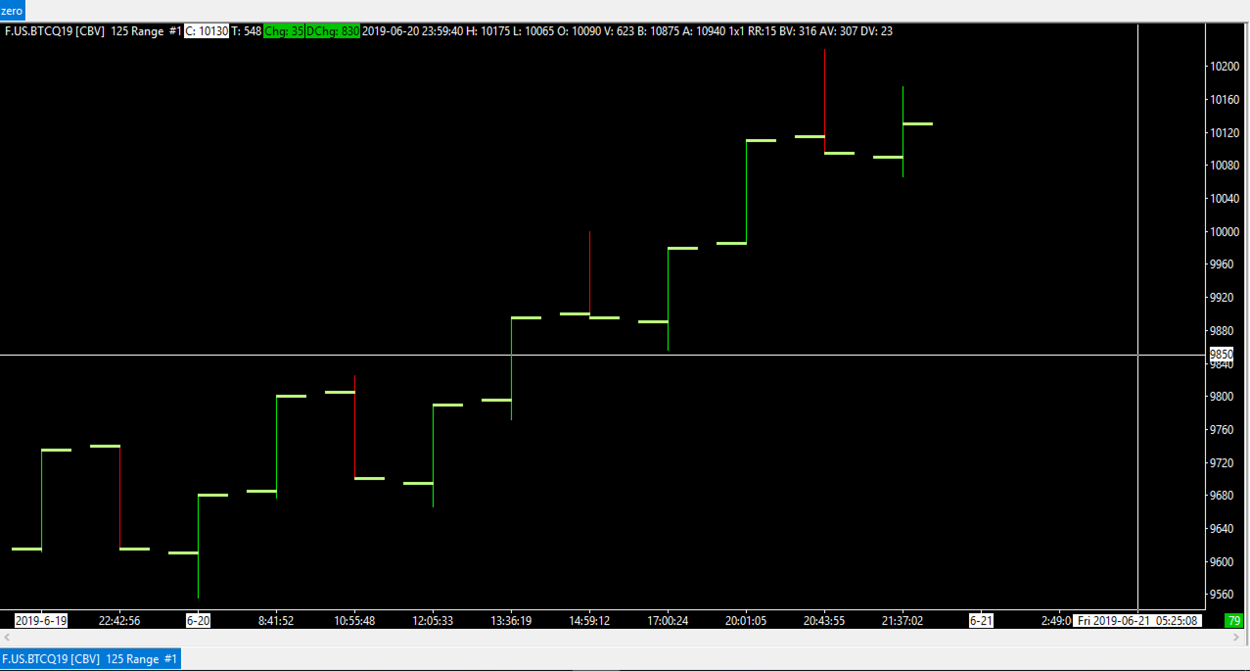

Specifically, in the example here, the chart shows these timestamps (in Chicago time zone):
displayed on chart bar begin times
2019-06-19 17:00:44
2019-06-19 22:42:56
2019-06-20 02:58:11
2019-06-20 08:41:52
2019-06-20 10:55:48
2019-06-20 12:05:33
2019-06-20 13:36:19
2019-06-20 14:59:12
2019-06-20 17:00:24
2019-06-20 20:01:05
2019-06-20 20:43:55
2019-06-20 21:37:02

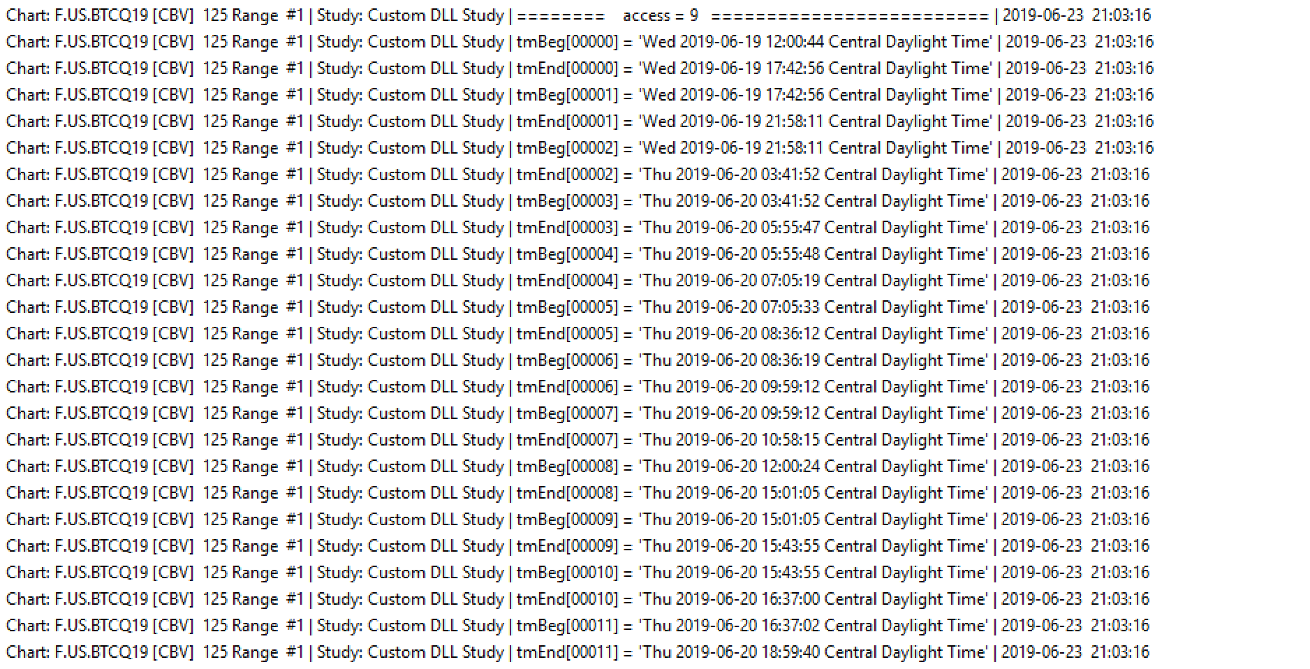

log output from running code:
Chart: F.US.BTCQ19 [CBV] 125 Range #1 | Study: Custom DLL Study | ======== access = 9 ========================= | 2019-06-23 21:03:16
Chart: F.US.BTCQ19 [CBV] 125 Range #1 | Study: Custom DLL Study | tmBeg[00000] = 'Wed 2019-06-19 12:00:44 Central Daylight Time' | 2019-06-23 21:03:16
Chart: F.US.BTCQ19 [CBV] 125 Range #1 | Study: Custom DLL Study | tmEnd[00000] = 'Wed 2019-06-19 17:42:56 Central Daylight Time' | 2019-06-23 21:03:16
Chart: F.US.BTCQ19 [CBV] 125 Range #1 | Study: Custom DLL Study | tmBeg[00001] = 'Wed 2019-06-19 17:42:56 Central Daylight Time' | 2019-06-23 21:03:16
Chart: F.US.BTCQ19 [CBV] 125 Range #1 | Study: Custom DLL Study | tmEnd[00001] = 'Wed 2019-06-19 21:58:11 Central Daylight Time' | 2019-06-23 21:03:16
Chart: F.US.BTCQ19 [CBV] 125 Range #1 | Study: Custom DLL Study | tmBeg[00002] = 'Wed 2019-06-19 21:58:11 Central Daylight Time' | 2019-06-23 21:03:16
Chart: F.US.BTCQ19 [CBV] 125 Range #1 | Study: Custom DLL Study | tmEnd[00002] = 'Thu 2019-06-20 03:41:52 Central Daylight Time' | 2019-06-23 21:03:16
Chart: F.US.BTCQ19 [CBV] 125 Range #1 | Study: Custom DLL Study | tmBeg[00003] = 'Thu 2019-06-20 03:41:52 Central Daylight Time' | 2019-06-23 21:03:16
Chart: F.US.BTCQ19 [CBV] 125 Range #1 | Study: Custom DLL Study | tmEnd[00003] = 'Thu 2019-06-20 05:55:47 Central Daylight Time' | 2019-06-23 21:03:16
Chart: F.US.BTCQ19 [CBV] 125 Range #1 | Study: Custom DLL Study | tmBeg[00004] = 'Thu 2019-06-20 05:55:48 Central Daylight Time' | 2019-06-23 21:03:16
Chart: F.US.BTCQ19 [CBV] 125 Range #1 | Study: Custom DLL Study | tmEnd[00004] = 'Thu 2019-06-20 07:05:19 Central Daylight Time' | 2019-06-23 21:03:16
Chart: F.US.BTCQ19 [CBV] 125 Range #1 | Study: Custom DLL Study | tmBeg[00005] = 'Thu 2019-06-20 07:05:33 Central Daylight Time' | 2019-06-23 21:03:16
Chart: F.US.BTCQ19 [CBV] 125 Range #1 | Study: Custom DLL Study | tmEnd[00005] = 'Thu 2019-06-20 08:36:12 Central Daylight Time' | 2019-06-23 21:03:16
Chart: F.US.BTCQ19 [CBV] 125 Range #1 | Study: Custom DLL Study | tmBeg[00006] = 'Thu 2019-06-20 08:36:19 Central Daylight Time' | 2019-06-23 21:03:16
Chart: F.US.BTCQ19 [CBV] 125 Range #1 | Study: Custom DLL Study | tmEnd[00006] = 'Thu 2019-06-20 09:59:12 Central Daylight Time' | 2019-06-23 21:03:16
Chart: F.US.BTCQ19 [CBV] 125 Range #1 | Study: Custom DLL Study | tmBeg[00007] = 'Thu 2019-06-20 09:59:12 Central Daylight Time' | 2019-06-23 21:03:16
Chart: F.US.BTCQ19 [CBV] 125 Range #1 | Study: Custom DLL Study | tmEnd[00007] = 'Thu 2019-06-20 10:58:15 Central Daylight Time' | 2019-06-23 21:03:16
Chart: F.US.BTCQ19 [CBV] 125 Range #1 | Study: Custom DLL Study | tmBeg[00008] = 'Thu 2019-06-20 12:00:24 Central Daylight Time' | 2019-06-23 21:03:16
Chart: F.US.BTCQ19 [CBV] 125 Range #1 | Study: Custom DLL Study | tmEnd[00008] = 'Thu 2019-06-20 15:01:05 Central Daylight Time' | 2019-06-23 21:03:16
Chart: F.US.BTCQ19 [CBV] 125 Range #1 | Study: Custom DLL Study | tmBeg[00009] = 'Thu 2019-06-20 15:01:05 Central Daylight Time' | 2019-06-23 21:03:16
Chart: F.US.BTCQ19 [CBV] 125 Range #1 | Study: Custom DLL Study | tmEnd[00009] = 'Thu 2019-06-20 15:43:55 Central Daylight Time' | 2019-06-23 21:03:16
Chart: F.US.BTCQ19 [CBV] 125 Range #1 | Study: Custom DLL Study | tmBeg[00010] = 'Thu 2019-06-20 15:43:55 Central Daylight Time' | 2019-06-23 21:03:16
Chart: F.US.BTCQ19 [CBV] 125 Range #1 | Study: Custom DLL Study | tmEnd[00010] = 'Thu 2019-06-20 16:37:00 Central Daylight Time' | 2019-06-23 21:03:16
Chart: F.US.BTCQ19 [CBV] 125 Range #1 | Study: Custom DLL Study | tmBeg[00011] = 'Thu 2019-06-20 16:37:02 Central Daylight Time' | 2019-06-23 21:03:16
Chart: F.US.BTCQ19 [CBV] 125 Range #1 | Study: Custom DLL Study | tmEnd[00011] = 'Thu 2019-06-20 18:59:40 Central Daylight Time' | 2019-06-23 21:03:16

[2019-06-24 02:51:50]
uM8137 - Posts: 183
I see the time stamps all differ by exactly 5 hours, which is the Chicago (CDT) vs UTC time difference.
[2019-06-24 02:55:24]
uM8137 - Posts: 183
So I guess the bug is simply that the chart shows UTC times even when both
a) DTS -> TimeZone is set to Chicago
and
b) CS -> Advanced Settings -> Time Zone is set to Chicago
[2019-06-24 03:04:28]
