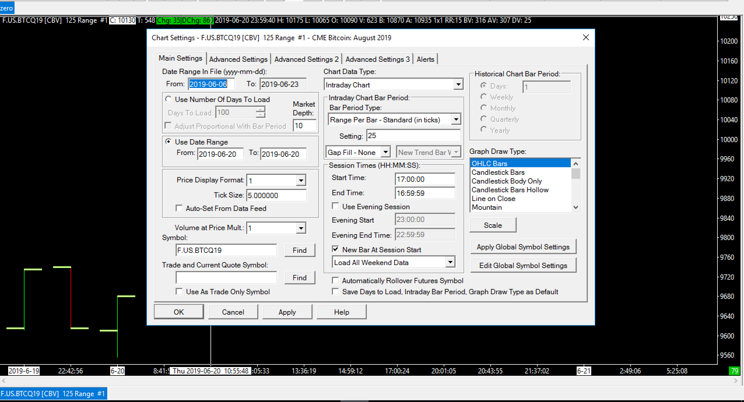

Post From: sc.BaseDateTimeIn values do not match displayed range bars on chart
[2019-06-24 02:41:03]
uM8137 - Posts: 183
SierraChart version: 1915
symbol: F.US.BTCQ19 [CBV]
data source: CQG FIX.
Bar Period Type: Range Per Bar - Standard (in Ticks), 25 ticks.
When I compare the timestamps reported in sc.BaseDateTimeIn (and sc.BaseDataEndDateTime) to
the timestamps on the chart at the bottom horizontal axis, they appear nothing alike.
Please see the detailed example in the two tables below, and the reproducer code included.
Prima facia, this seems like a rather serious problem in writing ACSIL trading systems.
But perhaps the SCDateTimeToUNIXTime() function is buggy?
Specifically, in the example here, the chart shows these timestamps (in Chicago time zone):
displayed on chart bar begin times
2019-06-19 17:00:44
2019-06-19 22:42:56
2019-06-20 02:58:11
2019-06-20 08:41:52
2019-06-20 10:55:48
2019-06-20 12:05:33
2019-06-20 13:36:19
2019-06-20 14:59:12
2019-06-20 17:00:24
2019-06-20 20:01:05
2019-06-20 20:43:55
2019-06-20 21:37:02
from running the print_timeline DLL study (see also 2nd screenshot):
times reported to the ACSIL DLL in sc.BaseDateTimeIn:
2019-06-19 12:00:44 Central Daylight Time
2019-06-19 17:42:56 Central Daylight Time
2019-06-19 21:58:11 Central Daylight Time
2019-06-20 03:41:52 Central Daylight Time
2019-06-20 05:55:48 Central Daylight Time
2019-06-20 07:05:33 Central Daylight Time
2019-06-20 08:36:19 Central Daylight Time
2019-06-20 09:59:12 Central Daylight Time
2019-06-20 12:00:24 Central Daylight Time
2019-06-20 15:01:05 Central Daylight Time
2019-06-20 15:43:55 Central Daylight Time
2019-06-20 16:37:02 Central Daylight Time
complete code for the ASCIL dll:

imagetimeline_BTCQ19_25tick_rangebar_graph.png / V - Attached On 2019-06-24 02:14:15 UTC - Size: 127.01 KB - 458 views
imagetimeline_output_log.txt.png / V - Attached On 2019-06-24 02:14:24 UTC - Size: 258.83 KB - 361 views
imagetimeline_chart_settings_25tick_rangebar_standard.png / V - Attached On 2019-06-24 02:20:32 UTC - Size: 239.08 KB - 428 views
