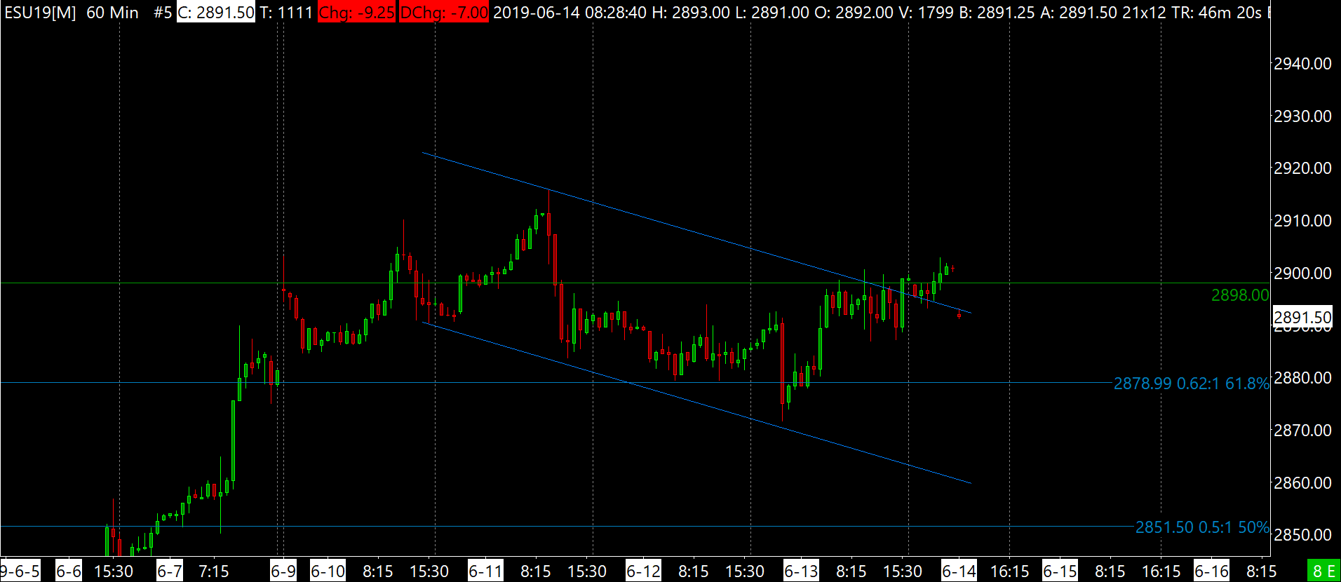

I logged into sierra today and noticed there was a gap on all my charts
How do i prevent this from happening so i can see the overnight data on intraday charts
http://www.sierrachart.com/image.php?Image=1560515322490.png
