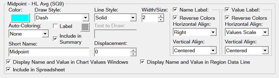

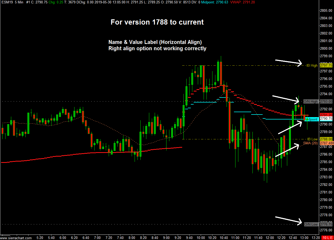

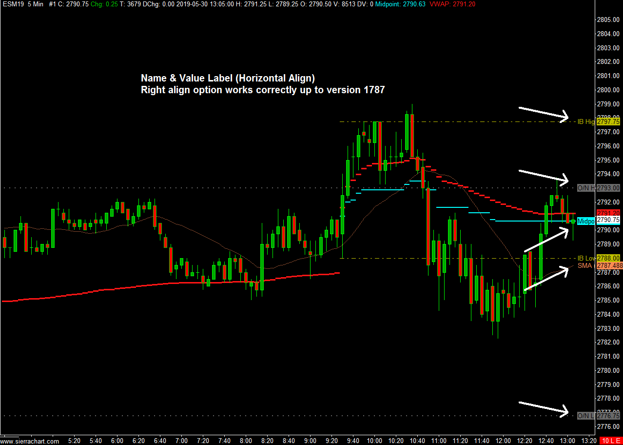

User823591 - Posts: 21
In the Subgraphs Tab / Name & Value Labels (Horizontal Align), there is a problem with the "RIGHT" Align option.
As explained on your site the other options (Left, Left Edge, Right Edge) are working as described.
The issue only occurs from version 1788 to the most current software version.
imageSubgraphs Tab - Name & Value Labels.JPG / V - Attached On 2019-06-01 03:53:57 UTC - Size: 59.52 KB - 474 views

[2019-06-01 23:26:06]
The alignment is intended to be relative to the right edge of the chart.
Create more space after the last bar:
Working With Charts: Right Side Fill Space

[2019-06-02 01:10:32]
Hello Sierra Chart Engineering,
I do understand that if you create more (right side) fill space for a given label that it will function correctly.
In versions 1787 & older (right side) fill space was not necessary when using the "RIGHT" align option.
Don't know about other users, but I prefer it functioning this way.
In my case I found it useful, especially when you have a Chartbook with multiple charts & you don't want to give up (BAR) display space.
I'm hoping that this can be corrected in an upcoming software version.
[2019-06-02 01:32:31]
This is how it works now. This is definitively not going to change at all .
Date Time Of Last Edit: 2019-06-02 01:32:38
