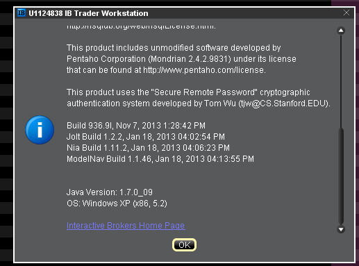

Hi Sierra Team,
Pretty worried, I updated all my Interactive Brokers software (Nov 13 version) but cannot connect to the API anymore.
The report tells me I am using server version 67 and need 68 minimun.
I checked the API Version, it says 9.70.
Do you know what could be the problem ? Shall I check into the API cpp Server files ?
Here is Sierra Chart Report
Connecting to IB data and trade server: 127.0.0.1. Port 7496. | 2013-11-25 21:53:41
The network socket is connected. | 2013-11-25 21:53:41
Socket connected to TWS. Sending client version: 62. Waiting for acceptance. | 2013-11-25 21:53:41
TWS server version: 67 | 2013-11-25 21:53:41
IB: Trader Workstation 9392 or higher is required to connect. TWS server version required: 68 | 2013-11-25 21:53:41
Error connecting to Data or Trading service. For help with this issue, press the Send For Analysis button on this window. | 2013-11-25 21:53:41
Thank you for your help,
Thomas

[2013-11-25 22:40:32]
Install the latest Trader Workstation with this link and you will be fine:
https://download2.interactivebrokers.com/download/tws40_install_latest.exe
[2013-11-26 09:18:38]
SoundsLikeSun - Posts: 30
Great
Thank you
