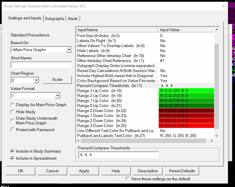

I was actually looking to see if the Numbers Bar Calculated Value field itself could highlight. So in my image above the 58314 would highlight as soon as it reaches or gets above say 300% the previous volume.
I will check this out too, thank you.
[2019-04-27 13:27:30]
WRBishop - Posts: 6
I am an idiot never mind.... this is already built into the study. Should have known SC already thought of it. Sorry for the trouble.

OK so not figuring this out. The study above from Ackin seems to be what I am looking for but I cannot find it.
I am looking for the following:
Numbers Bars Calculated Values:
When Current Bar Total Volume is 400% >= Previous Bar Total Volume Highlight Background Red
I thought the NBCV study accomplished this but it does not. I have tried the suggested Color Background Based on Alert Condition but cannot get it to trigger at all.
If this is not possible I would gladly take an alert that colors the entire Numbers Bar based on the same condition.
Any help would be greatly appreciated.
