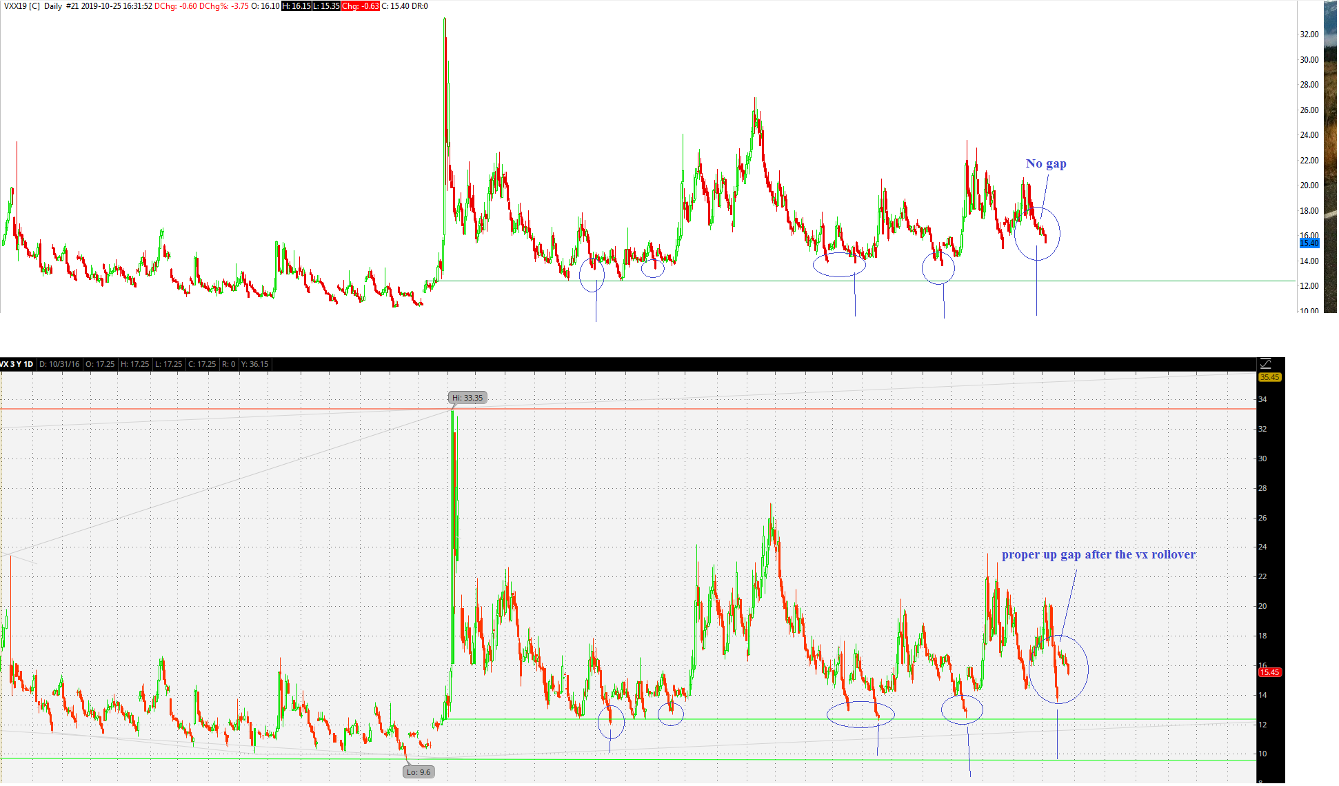

Rnn - Posts: 84
Thanks for the check, I don't know the technical reason but there is a clear difference after I updated - I follow this symbol everyday so I know it quite well
I've made a comparison to show you the difference - please check it on the attachment below
How do I rollback to the previous sierra version I had so I can show you the difference from there as well
please its an important chart for me - thanks again!
imagevx 25-10.PNG / V - Attached On 2019-10-25 20:46:41 UTC - Size: 122.61 KB - 444 views

This screenshot is not helpful to us and does not follow our specifications:
Make sure you know what contract months you are looking at, at each bar. Refer to:
Continuous Futures Contract Charts: Displaying Rollover Transition Times and Contract Months
Maybe the problem is you need to set the rollover rules as you require in the Global Symbol Settings:
And also enable Global Settings >> Symbol Settings >> Use Custom Symbol Settings Values.
Date Time Of Last Edit: 2019-10-28 11:52:01

Rnn - Posts: 84
I checked and the problem is the same as I started the thread - that's why the low values I see now are higher than it should be - since the rollover dates are earlier than should be
So the problem now is that after I custom change it to 30 days (please check John's comment above) the rollover date isn't actually changed (after reload and calculate and also restarting Sierra)
So I think In one of your recent version updates something is preventing the custom change to take place
Date Time Of Last Edit: 2019-10-29 17:19:04
