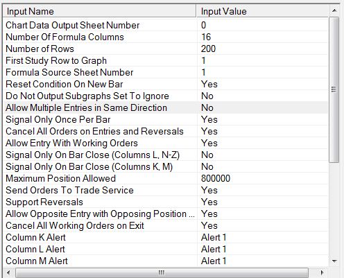

My Spreadsheet_System_for_Trading Settings are as shown in the attached jpg
I've, in addition, tried to set J28 as: =IF(J42>=A3;TRUE;FALSE) as described by tomgilb here => Prevent spreadsheet trading if there was already an order in the present bar
But the problem remains.
Do you have any suggestion on solving this issue, please ?

imageSpreadsheet_Study_For_Trading_Settings.JPG / V - Attached On 2013-11-21 17:36:38 UTC - Size: 62.77 KB - 792 views

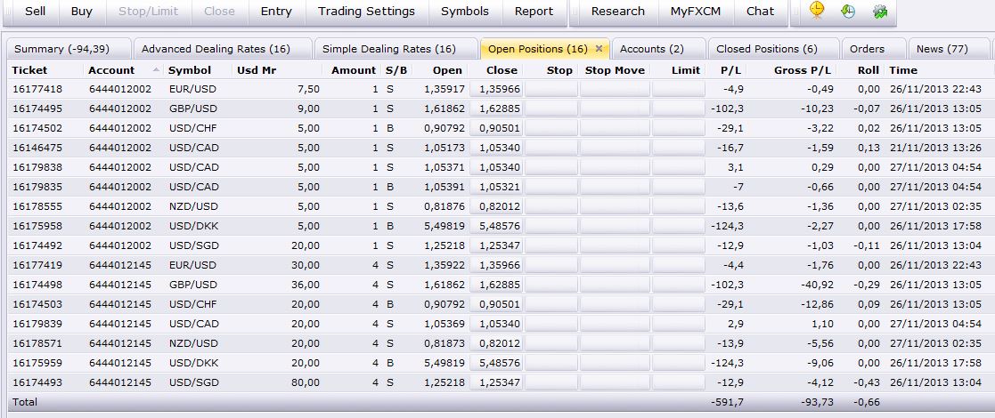

Again, it happened several times. (I'm attaching some pictures, made on the FXCM TradeStation for monitoring the trades)
For a detailed analisis, the complete system we're running is as follows:
1) One single PC 7core, and CPU running between 30% and 70%, (not so busy)
2) Seven SierraCharts engines running at the same time, independent and identical Automated Systems, one on each Forex PAIR
3) Each of the seven identic Automated System has 8 Charts with their corresponding SpreadSheets pages and one SpreadSheet-for-Alerts and one Spreadsheet-for-Trading
4) A hutch quantity of formulas and calculations on the Spreadsheets.
5) The seven SierraCharts Automated Systems trade on the same "primary" account at FXCM vía FIX connections.
6) A FXCM propietary software, (TradeCopier VPAMM),replicates all trades from the "primary" account (xxxx2002)to a "Main" account (xxxx2145), multiplying Size by four. (due to internal administrative reasons, we need to keep both accounts separated)
7) As long as we've seen, the problems on the double-trades occurs just on the "primary" account, that is, the one driven by the SierraCharts Automated Systems.
8) The observed problems are of two differente kinds:
a) What should be a single shot trade, results in two different possitions in the market (just on the "primary" account, but not in the "Main" one) with same correct Size each of them.
b) Sometimes, when a Reversal should take place (during this "debugging" time, we made the Systems first to flatten the existing position and then go into the new Reverse position), the existing position had not been flattened, thus keeping co-existing the previous (say e.j. Long one) position, the one which should Flatten it (say e.j. Short) and the new Reversed position (say e.j. Short one) all three with same correct Size and, for both Shorts, same Entry Time and aproximatly same Entry price, all said just in the "primary" account.
9) Finally, after the last change, switching to "NO" the Cancel Working Orders on Entries and Reversals yesrterday night, a new error has been observed in three different Pairs, which is, the correct Size should be 5 and, instead, in one pair it was 9, in another Pair it was 7,5 and in the third Pair it was 20.

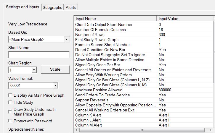

I'm attaching the following Files:
1) Current SpreadSeet-For-Trading Settings
2) Two examples, showing incorrect trades on different Pairs.

image3x_CAD_on_Primary_EUR_7.5Size_GBP_9Size_SGD_20Size_on_primar.JPG / V - Attached On 2013-11-27 12:15:12 UTC - Size: 144.34 KB - 764 views
imageSpreadSheet_Settings_27112013.JPG / V - Attached On 2013-11-27 12:15:22 UTC - Size: 84.59 KB - 754 views
imageSGD_20_GBP_9_EUR_7_5_NZD_2B&1S.JPG / V - Attached On 2013-11-27 12:15:52 UTC - Size: 145.19 KB - 725 views

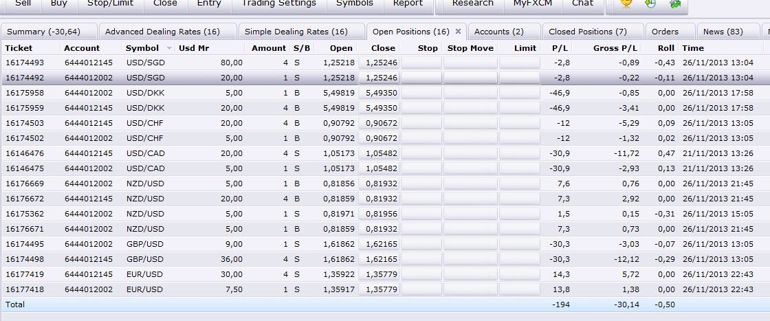

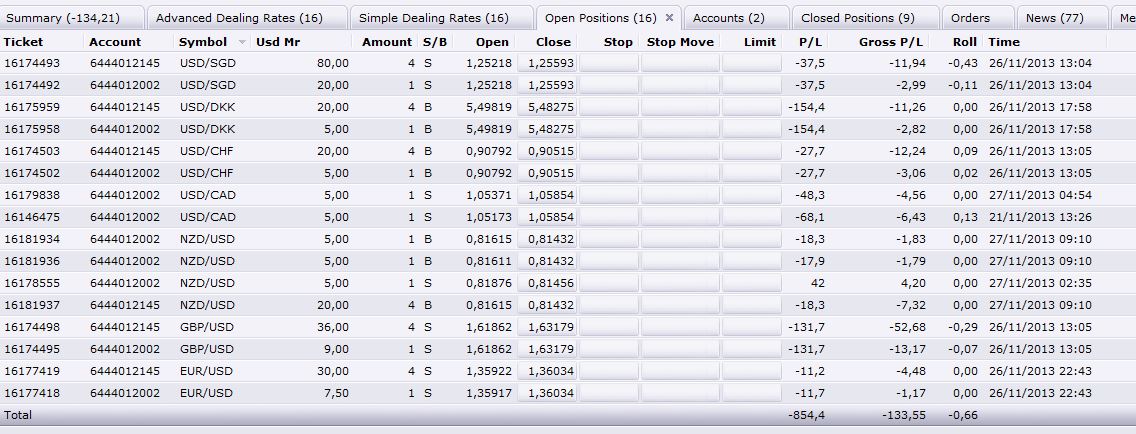

[2013-11-27 14:37:36]
JordiE - Posts: 40
Hi, again, it can be seen here what happened a while ago....
Another example about what has been said in my previous Post in Poin 8b)...
"b) Sometimes, when a Reversal should take place (during this "debugging" time, we made the Systems first to flatten the existing position and then go into the new Reverse position), the existing position had not been flattened, thus keeping co-existing the previous (say e.j. Long one) position, the one which should Flatten it (say e.j. Short) and the new Reversed position (say e.j. Short one) all three with same correct Size and, for both Shorts, same Entry Time and aproximatly same Entry price, all said just in the "primary" account."
Find attached a couple of pictures, and note the previous two Short positions USDNZD,(one on each account) entered on 27/11/2013 at 2:35 hs. and, in the next picture, how it remains just the Short position on the xxxx2002 "primary" account and there are two additional Buy positions with Entry Time 27/11/2013, 9:10 hs, on the xxx2002 "primary" account and one Buy Position also with same entry Time 27/11/2013, 9:10 hs on the xxxx2145.
It seems that the previous Short position on the xxx2145 Account has been succesfully reversed to a Buy position entered at 27/11/2013 9:10, BUT in the xxx2002 "primary" account, (driven by SierraChart) the existing previous Short position HAS NOT been Flattened, thus remaining both BUY positions (one to Flat the existing one and the second one to go into a new Buy position) entered at 27/11/2013, 9:10, plus the exiting Short one, entered at 27/11/2003, 2:35 hs.
Let me hear your comments, whenever you have them
As always, many thanks for your support
Best regards
Jordi
