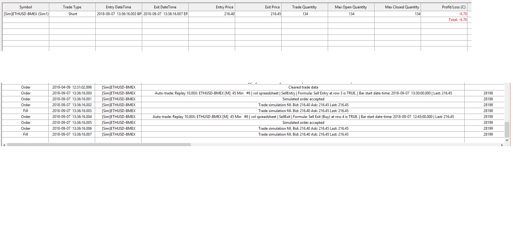

I would sometimes have my position exits execute immediately after entering w/ a discrepancy of .004;
The position opens at "0.003" after the bar and closes at "0.007" right after(I'll provide an image)..
I do have "Signal only on bar close L - N/Z" selected and I'm thinking there might be some type of timing problem
Any suggestions on how to fix this issue? Is there a way to change the time at which an entry executes after a new bar is put in session(instead of it being 0.003 all the time)?
imagetiming.png / V - Attached On 2019-04-09 21:41:28 UTC - Size: 37.6 KB - 472 views

Not really,
It just so happened that the previous bar closed its position(and is set to exit on bar close), and the present bar has an open at whenever opening conditions are met(in this case ~6min after 13:30 bar opening)..
Not sure if the previous bar closing is related to the issue, but I suspect it is...

User917679 - Posts: 76
This bit is definitely helpful - I wish I had known this earlier as I had developed a long-winded workaround to resolve a prior problem that could have been simply fixed by this(lol)
But for some reason, the immediate close at the spot depicted in the image seems to persist;
Like I said, I worked around the problem at bar beginnings/endings, but now the situation rises all throughout the bar wherever there is an opening
Edit:
Finally worked it all out - enabling "Strict Signal Only On Bar Close Evaluation" was necessary I think.
Thanks again.
