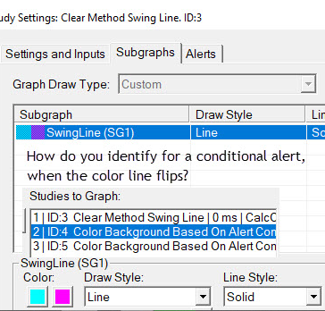

I am looking for how to do a conditional alert on the Clear Method Swing Line.
The slope change worked, but it does not capture the Clear Method Swing Line “flips.”

[2019-03-27 15:43:16]
John - SC Support - Posts: 48095
What you are seeing is just due to how the Line and the Background are drawn. The line is from the middle of one bar to the next, therefore when it changes in the next bar, it looks like it started at the previous bar, where as all it is doing is connecting the values between the two bars. The Background coloring is just filling in the width of the bar in which the event took place.
Really, what you are seeing is correct, as the Background is showing where the bar is on which the event occurred. If you change the Clear Method Swing Line study to Dash, it will become more obvious.
An option that is available, although we do not think you need it, is to use the Displacement value of the subgraph for the Color Background Based on Alert Condition study, you could set this to -1 to make the background change show up one bar previously, but it will also show the end of the change one bar previous. You will have to determine what works best for how you view your data. Refer to the following for the Displacement option:
