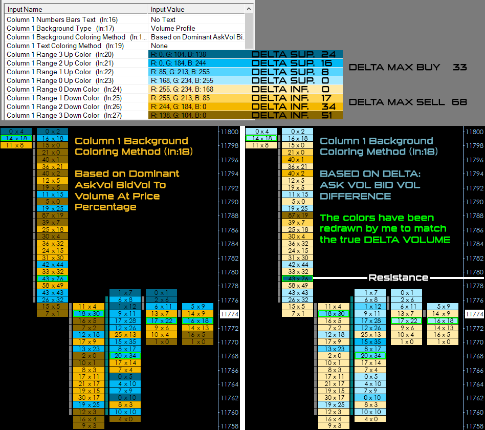

It would be perfect to add in the NUMBER BAR, the ability to display the color according to the delta volume, not in percentage, but compared to the largest number of a candle price?
I have attached an explanatory image.
Option 1: The client defines the value of each delta relative to a color.
Exemple:
Color of a positive delta:
Color 1 greater than "0"
Color 2 greater than "30"
Color 3 greater than "60"
Color 4 greater than "90"
Color of a negative delta:
Color 1 less than "0"
Color 2 less than "30"
Color 3 less than "60"
Color 4 less than "90"
Option 2: The color is automatically calculated between 0 and the delta maximum volume of each tick relative to the candlestick or in relation to the daily session.
Thank you in advance for all the work you have done so far.
Dorian

From what you are describing this already exists in the Numbers Bars study. There are two options for the Background Coloring methods that would apply here: Based on AskVol BidVol Difference - Actual and Based on Diagonal Dominant AskVol BidVol Difference - Actual - the only difference between these options is that one does a direct comparison at the given price and the other does a diagonal comparison. You will find the descriptions of these options here:
Numbers Bars: Numbers Bars Background Coloring Methods
When using a Background Coloring Method that uses Actual values, the coloring is then based on the settings in the Column # Actual Volume Compare Thresholds, in which you set the actual volume difference values that define the Column # Range # Up/Down Color that will be used. Refer to the documentation here for this Input:
Numbers Bars: Column # Actual Volume Compare Thresholds
