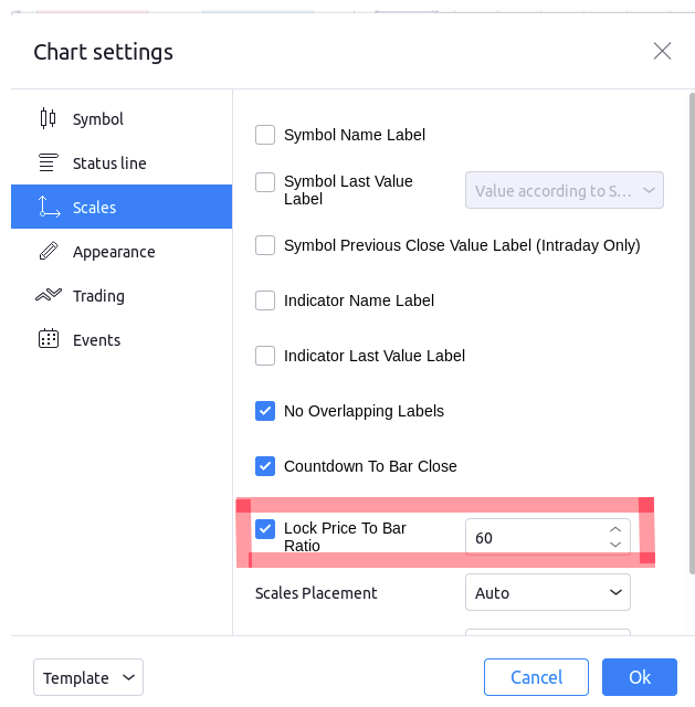

User138943 - Posts: 1
Hi, I'm having the same issue. Which seems to be more about this price bar x ration he mentions in his 1st question than the Gann Fan itself.
Simply put, I'm struggling to find the equivalent of the the tradingview setting I added as attachment here:
Thanks in advance :)

[2019-06-25 15:03:35]
John - SC Support - Posts: 48095
We do not know what that setting does exactly, so the only thing we can recommend is to try out the various options and see which works for what you want. Refer to these settings starting here:
Chart Drawing Tools: Common Tool Configuration Settings and Chart Drawing Properties for Gann Grid and Gann Fan
One other thought that may be what you are really asking - the Gann Fan is always locked relative to the both scales when it is drawn. It is not possible to unlock it. Therefore, once you have set the ratio you want using one of the three settings, that ratio is set for that Gann Fan, regardless of how you change the scales.
