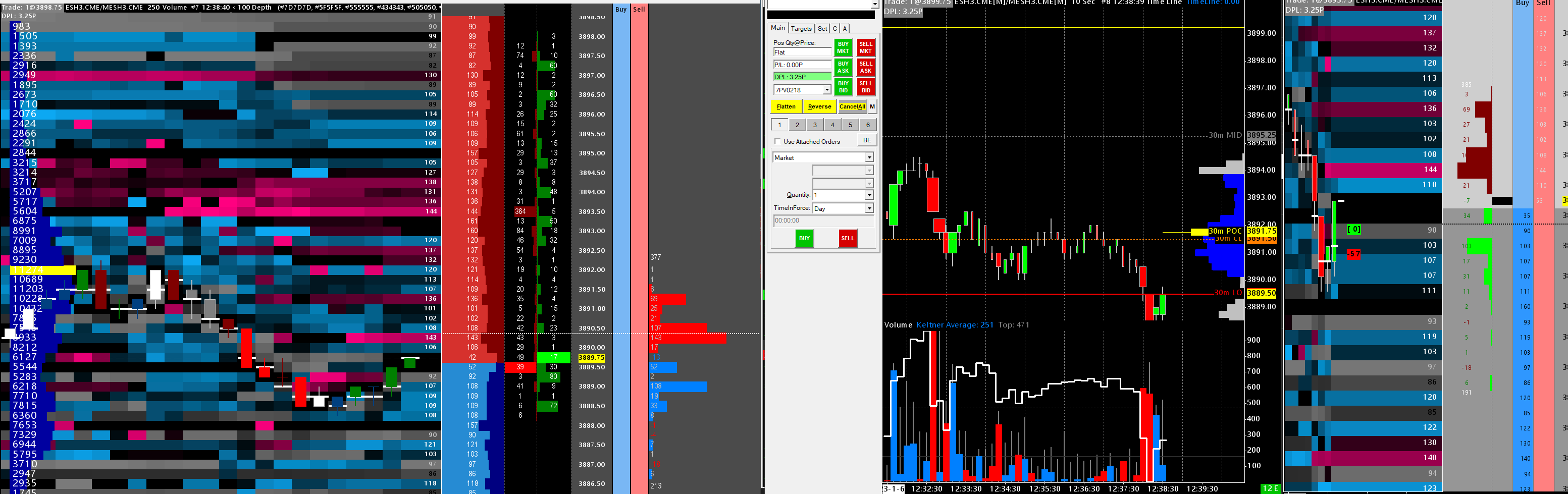

[2023-01-06 17:45:47]
TopGunTrader - Posts: 313
I was just going to ask this question but found this on support forum. This is a real shame because everything that happened in the past is NOT relelevant to trades right now and it has a fast decay. What happened in last 5 secs is 3x more important than 30 secs ago and 100x more than 3 mins ago
There NEEDS to be a setting show for X bars back.
Chart pic will tell the story LEFT one is as it is now. RIGHT side has 2 charts same time frame so the market depth doesn't make the chart completely unreadable.
Please consider fixing this.
imageCapture.PNG / V - Attached On 2023-01-06 17:43:10 UTC - Size: 369.96 KB - 265 views
