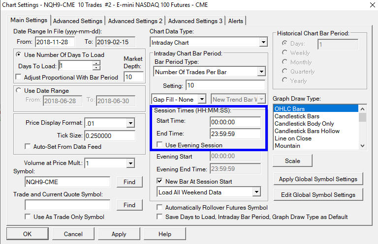

User16876 - Posts: 15
Do you have a Session Start Time in Chart settings set to 9:30:00 as well?
imageSessionStart.jpg / V - Attached On 2019-02-16 16:53:13 UTC - Size: 115.48 KB - 466 views

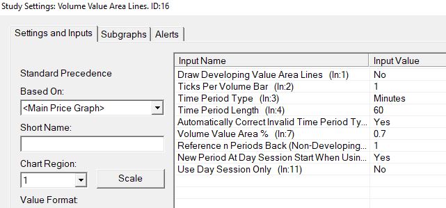

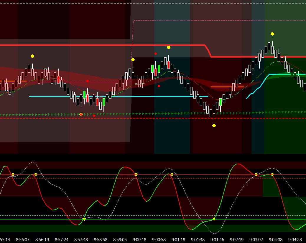

Devil_On_WallStreet - Posts: 67
YES!!! Well I use Chicago time so my chart says 8:30... I'm attaching some Jpegs... first are the study settings, 2nd shows the session start @ 8:30... 3rd shows the Volume Value Area Lines shifting @ 9:00 after only 30 minutes.
imagesettings.JPG / V - Attached On 2019-02-17 01:04:05 UTC - Size: 48.8 KB - 448 views
imagesess_start.JPG / V - Attached On 2019-02-17 01:04:54 UTC - Size: 168.35 KB - 445 views
image30min.JPG / V - Attached On 2019-02-17 01:05:05 UTC - Size: 120.01 KB - 403 views
