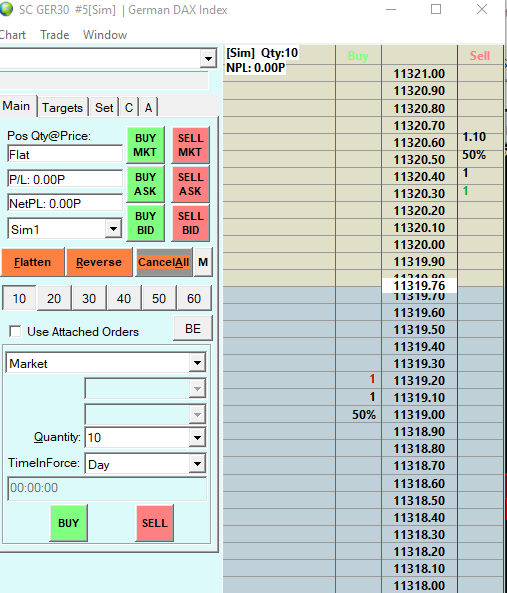

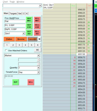

I currently have the Sierra Chart 15-day trial version.
I use SC DATA - All Services and I want to use that.
My problem is that I can not configure the DOM, I have depth that appears
in the columns Buy and Sell and I do not find how to do it.
I enclose a screenshot of what I would like (PHSC01.PNG) and what I get (PHSC02.PNG).
If you can help me, thank you
cordially

For market depth for the DAX would require that you use the Sierra Chart Exchange Data Feed and activate the EUREX exchange. Complete documentation is here:
This data feed is an extra cost.
