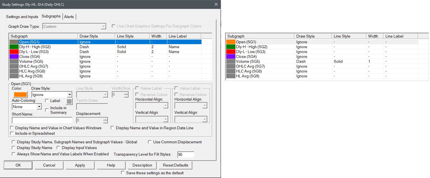

At the moment I use the left setting. But if I want to change something I get the right picture

[2019-01-30 19:41:55]
Here is the documentation for that study:
Daily OHLC
You will want to set this Input to Yes with the study:
Display Total Daily Volume Only

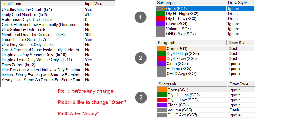

nicktrader - Posts: 817
Pls take a look on the pic. From my point of view my settings are correct and there is a "bug" (Ver.: 1865)

[2019-01-31 06:56:11]
Only the Volume Subgraph will be enabled when you have set Display Total Daily Volume Only to Yes. The documentation does explain this.
