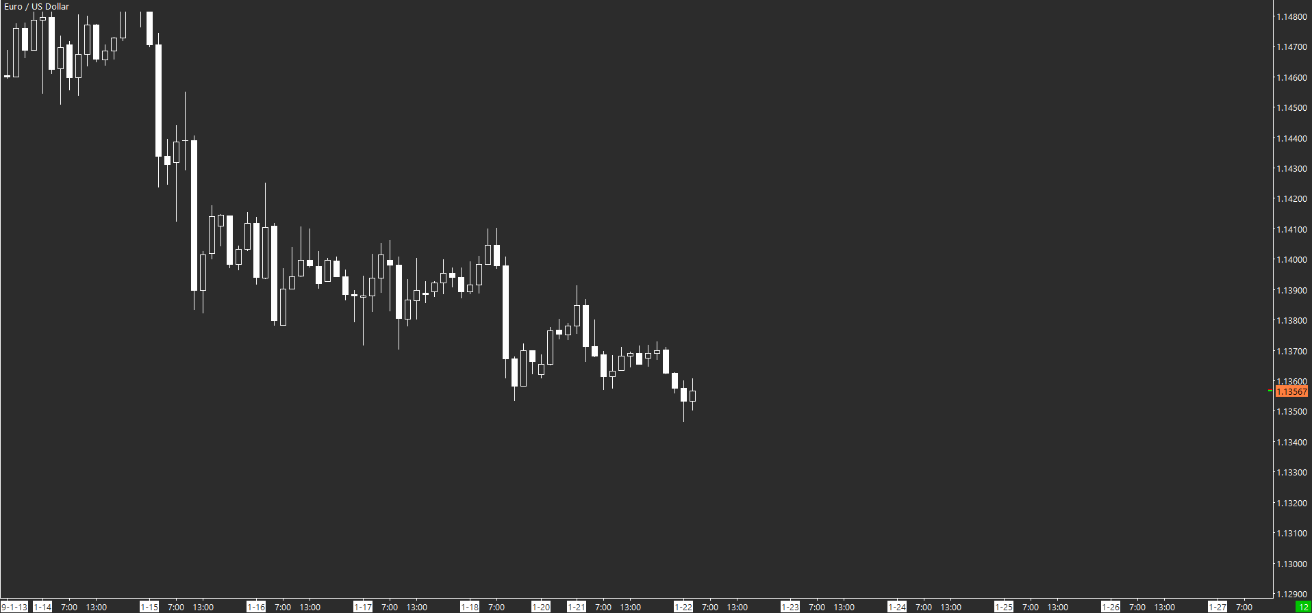

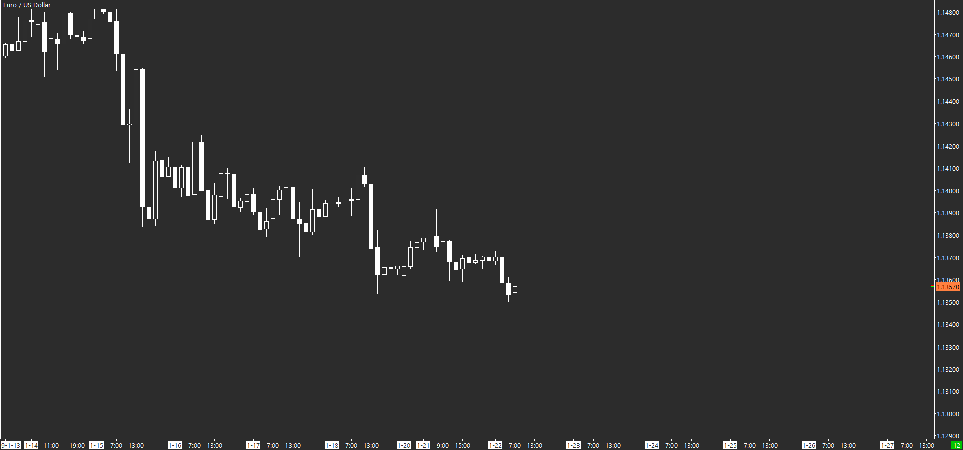

grantx - Posts: 244
This is when the system is set to New York Time Zone:
http://www.sierrachart.com/image.php?Image=1548146288652.png
This is when the system is set to London Time Zone:
http://www.sierrachart.com/image.php?Image=1548146240158.png
The candle structure is completely different depending on which timezone is selected. I need the candles to be based on the New York close BUT I need to see my local time on the horizontal time scale.
