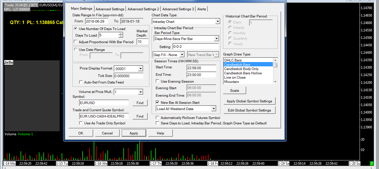

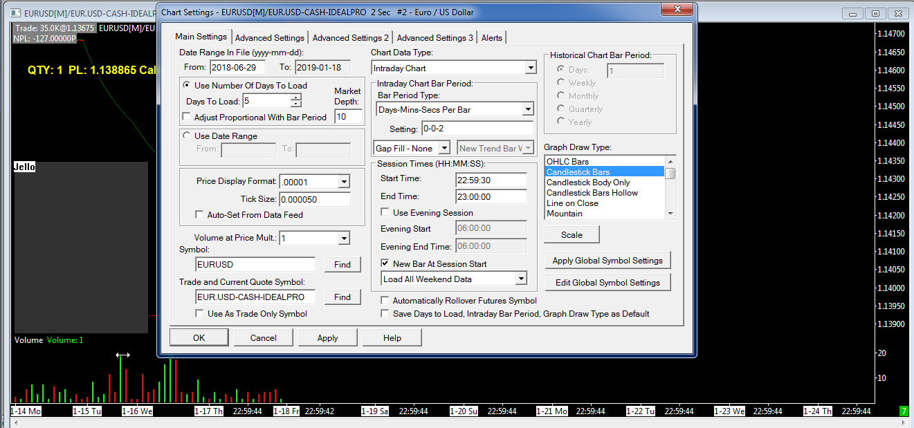

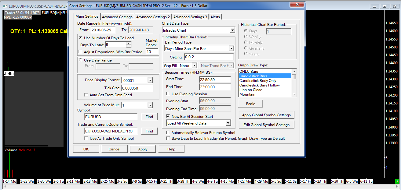

[2019-01-18 17:11:06]
PeterSt - Posts: 36
Chart Session Times
In the case where the Start Time is less than End Time, then there is never an adjustment to the trading day date of the bar.
Is what you see in the attachments a feature ?
(no bug, no need to solve anything)
I am really sorry to bother you so much. And if you feel you should charge me for having questions as a new paying customer, then you must do so. I suppose I'll survive.
imageSierra26h.png / V - Attached On 2019-01-18 16:56:13 UTC - Size: 88.48 KB - 477 views
imageSierra26i.png / V - Attached On 2019-01-18 16:56:27 UTC - Size: 105.41 KB - 451 views
imageSierra26j.png / V - Attached On 2019-01-18 16:56:34 UTC - Size: 103.69 KB - 371 views

[2019-01-21 11:02:10]
PeterSt - Posts: 36
they are set to show data for each day ranging from 1 minute, 30 seconds or 1 second.
This was to show you without too many long-winded wording what the issue appeared to be after this upgrade. Btw, I now hardly dare to say anything any more.
What must have happened after that upgrade is that I there abusively entered 22:59:59 while it should have been 23:00:01 (while for 100% sure the start time was 16:00 or about that from previous day testing).
What I showed with the latter 3 screenshots is that when the chart time-period is shorter than what the time-period implies, it starts to show the future. So the fewer time to show (like one second only) the more of the future shows.
Now knowing what happened I would never call this a bug and merely pilot error (me) which can't be withstanded by any software. Please leave it be, because your work is great as it is.
