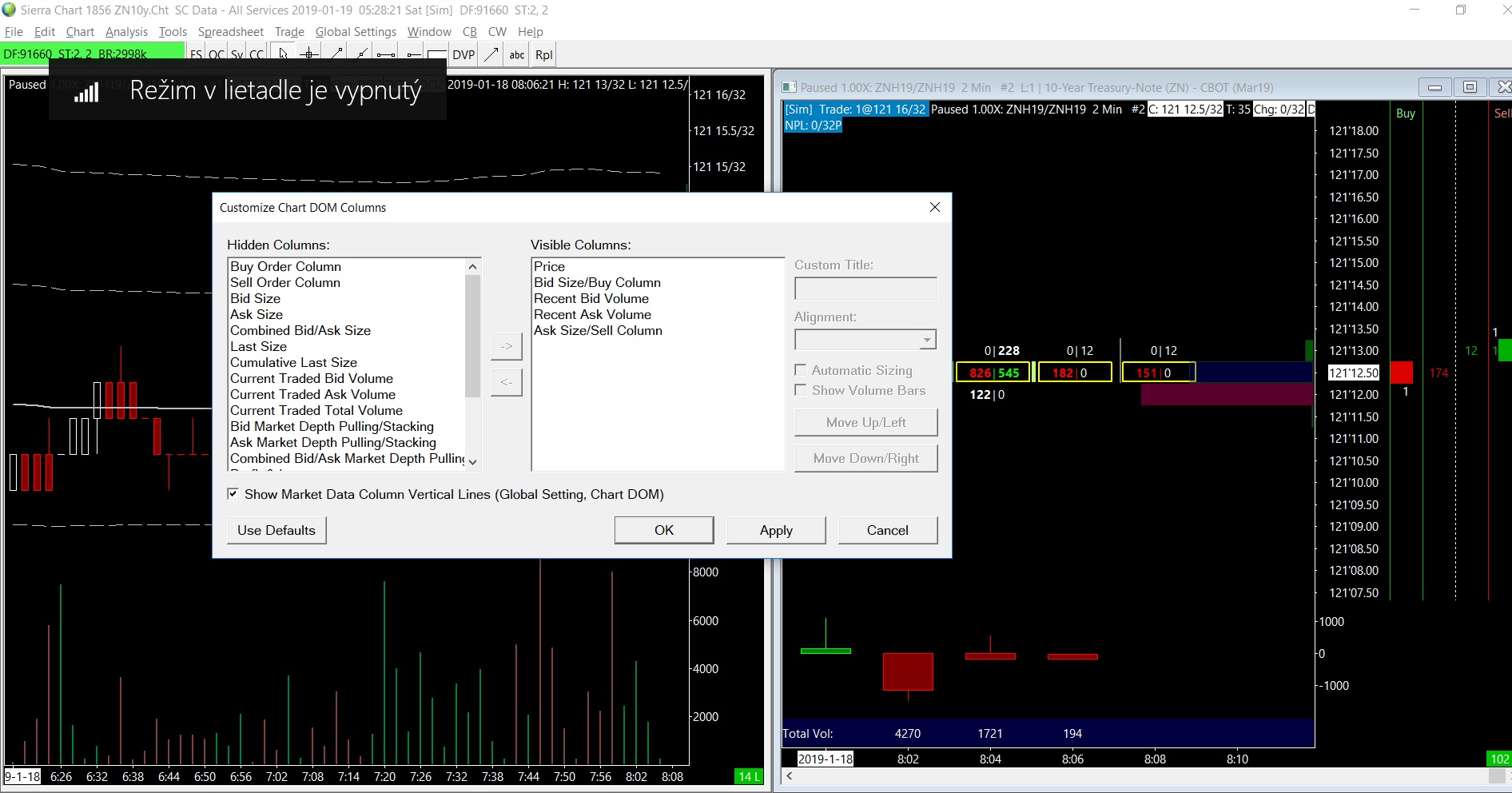

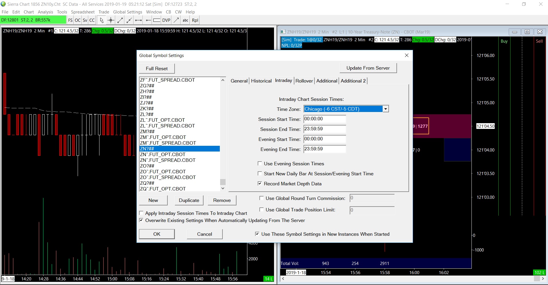

[2019-01-19 11:54:33]
dreamtea - Posts: 3
File attached
imagesymbol.jpg / V - Attached On 2019-01-19 11:54:15 UTC - Size: 381.9 KB - 609 views
imagecollumns.jpg / V - Attached On 2019-01-19 11:54:19 UTC - Size: 351.1 KB - 553 views
[2019-01-21 15:26:23]
John - SC Support - Posts: 48446
Ok, we need to step back to basics then, as we really do not know why this is happening.
First, this should not have any impact, but we notice that you have the Trade and Current Quote Symbol set to the same symbol as the main chart. There is no reason to have this, so you can remove that entry from Chart >> Chart Settings.
Second, do you have the full Market Depth displaying when you are not running a replay? If not, then we will need to figure that out first. If this is only an issue during replay, then let us know for sure.
