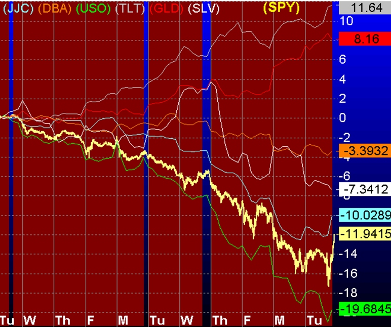

multiple sybols with sme starting point on the left side and 5scale on the right side
View Count: 1056
[2019-01-15 20:15:03]
User472677 - Posts: 391
Please see attached.
A common requirement to figure out correlations is to have multiple symbols on a chart -- starting point zero for all symbols and % scale on the right side. this is the standard for comparing multiple symbols.
I have looked at your documentation on add symbol and overlay studies but can not figure out the scales. please help.
imagecorrelation spy tlt gld.jpg / V - Attached On 2019-01-15 20:10:49 UTC - Size: 256.99 KB - 390 views

You need to use the Add Additional Symbol study, but the other study you need is Percent Change Since Open. You would then add all the symbols you want using the Add Additional Symbol study (you could hide these studies if you do not want to see them) and then add a Percent Change Since Open study for each symbol and put it them all in the same region.
Just make that you change the colors of the Study Subgraphs to what you want for each symbol.
Refer to the following for the Percent Change since Open study:
And:
