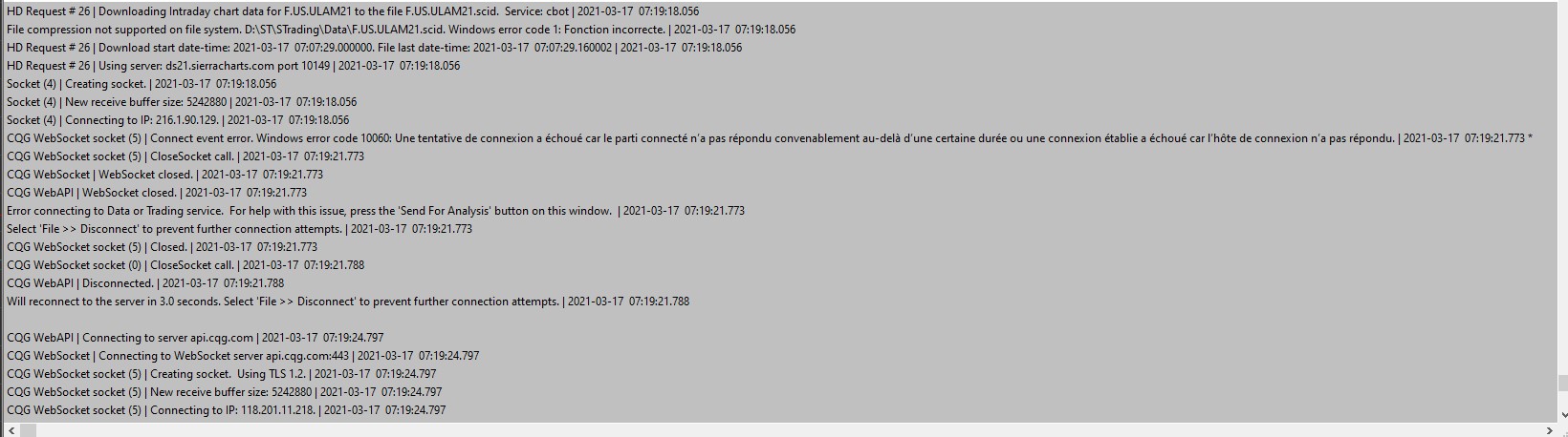

[2021-03-17 05:34:51]
Crystal77 - Posts: 28
SAME PROBLEM !! SOME PEOPLE HAVE SOME SOLUTION ABOUT THIS ?????? SC CANT HELP !!!!!!!!!!!!!!!!!!!!!!!!!!!!!!
allll0OOOOOOOOOOOOOOOOOOOOOOOOOOOO HEEYYYYYYYYYYYYYYYY
[2021-03-17 06:20:54]
File attached
imageSCC.jpg / V - Attached On 2021-03-17 06:20:42 UTC - Size: 148.93 KB - 415 views
[2021-03-17 08:06:12]
Regarding post #4 and post #5, this is a CQG connectivity issue. That is not something we can help with. Other than to refer you to:
CQG Trading Platform Service: Frequent Server Disconnections when Using CQG
The section linked above is a different type of issue, however It does have relevant information.
