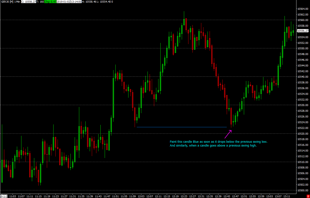

I wonder if there already is an indicator or study that could achieve this functionality - I did look through the list of indicators but could not find a good match.
I would like to colour a bar/candle as soon as it goes lower than a previous Low swing point. (Not just a previous bar - that's not useful). The point is that quite often a bar would come very close to the previous swing Low/High and then reverse. The difference could be a tick or two and not immediately clear whether the previous swing point was taken out or not.
Here is a chart snippet indicating the desired functionality: http://www.sierrachart.com/image.php?Image=1546433925858.png
And a similar functionality for "current bar/candle going above the previous swing high".
Maybe there is something that does this already; maybe this is something I could put together from existing parts or maybe this is something you could add in upcoming versions of Sierra? I need something that is quick/easy to use on a fast moving chart. Drawing a line and setting up an "alert" on that line requires too many clicks.
Thank you,
Andrei
[2019-01-02 21:58:14]
Use these studies:
Color Bar Based on Alert Condition
Swing High and Low

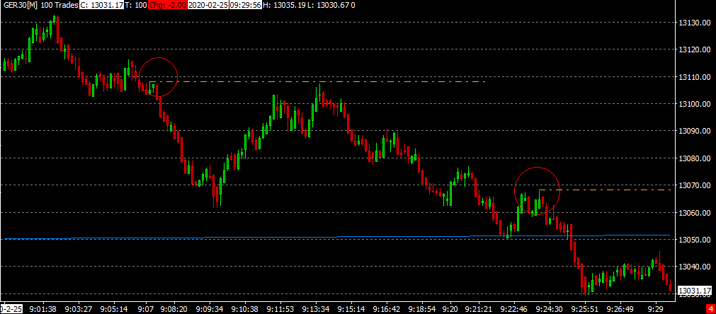

I wonder if the functionality I want already exists or maybe this is something I could add/customise/program myself or perhaps you could add it in the near future.
What I want is to draw a Horizontal Ray from the highest/lowest point of a swing. I don't know if detecting a swing programmatically is an easy thing or not. And I can see 2 possibilities here.
1) some code detects every swing high/low and draws a Horizontal Ray from the outer point of it.
2) I perform some kind of Fn+click on a bar and a Ray is drawn from high or low of that bar, as appropriate.
I looked at Swing High And Low study and it does something similar to what I want (with the "extend lines" option), but the chart gets overloaded by too many lines, which can not be deleted.
Perhaps you could make it possible to right-click and Erase any of those auto-generated lines? That would probably cover my needs for now.
Speaking more broadly, it might already be possible to draw a tool-line based on outputs generated by a study?
Could you please advise if something like this is available or could be done.
Here is an example of what I'm after. Note there are no excessive lines/rays off of every small swing:
http://www.sierrachart.com/image.php?Image=1582622230894.png
Thank you,
Andrei

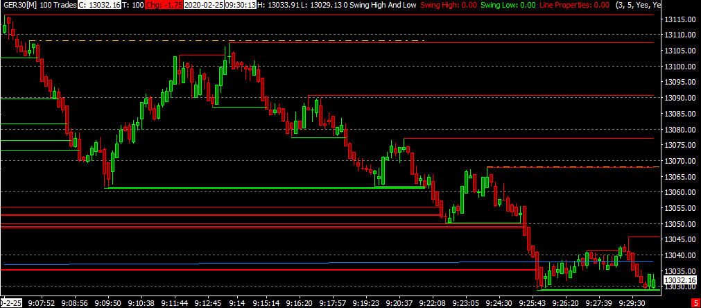

If I use "Swing High And Low" study from the "F6" list then I get lots of lines:
http://www.sierrachart.com/image.php?Image=1582667806617.png
And there is no way to remove/hide any of those. If there was a way/option to erase any of those lines then such a study would be a good option for me. Is this possible somehow?
I searched the Support Board for "ACSIL Swing" and didn't find anything specific. Is there any specific study/functionality that does something like this?
Thanks!
Andrei
[2020-02-25 22:31:33]
Ackin - Posts: 1865
I don't know what study you're using. Probably default Sierrachart study.....The image above (#4) is one of the variants of the study that I created and which is free to download on our czsk forum.
