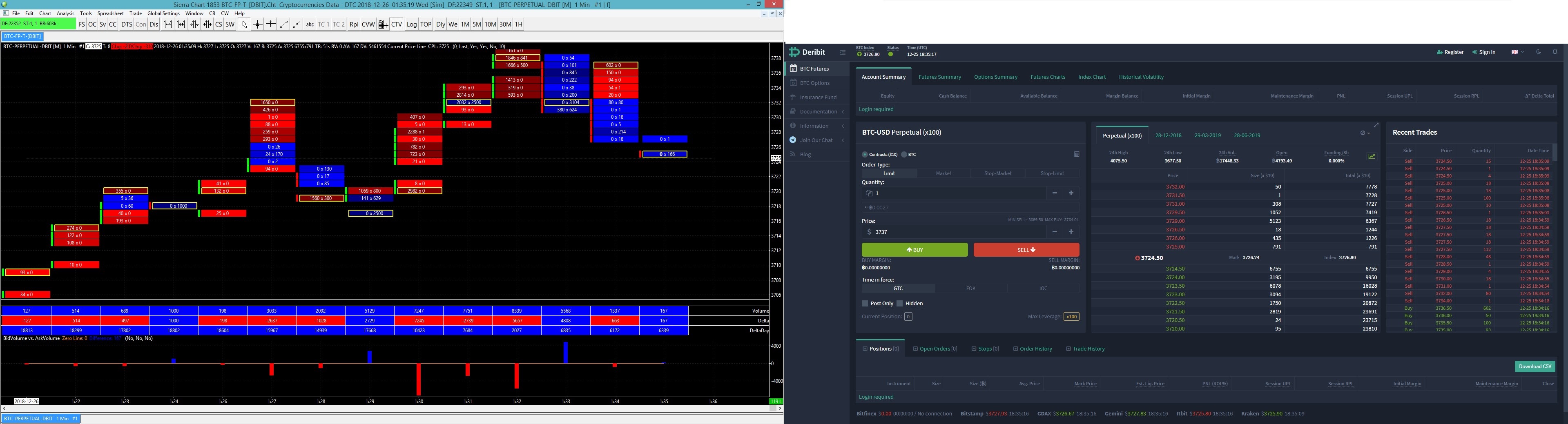

5. I'm not sure if I should open a new thread for it, but it seems like the Bid Vol and Ask Vol numbers are reversed for Bitcoin(I only checked it on Deribit Bitcoin, not on other exchanges). I attach a screenshot showing 1M Numbers Bars on the left side(BTC-DERIBIT), and on the right side Deribit website. See the Recent Trades on Deribit website showing there are only Sell trades, but Sierrachart shows it as Ask Vol in the Numbers Bar.
EDIT:
Iv'e just checked the same chartbook on a Bitmex BTC feed, and it seems like things working fine there. So the problem is likely to be with Deribit feed only.
Date Time Of Last Edit: 2018-12-26 14:54:57
imageSC issue.jpg / V - Attached On 2018-12-25 20:02:02 UTC - Size: 710.67 KB - 684 views
[2018-12-26 19:02:00]
1. This is supported. Here is the complete list:
Numbers Bars: Numbers Bars Background Coloring Methods
2. No, from our perspective this makes no sense.
3. No.
4. That setting is not applicable to that type of symbol.
5. Yes we do see this problem. This will be fixed today.

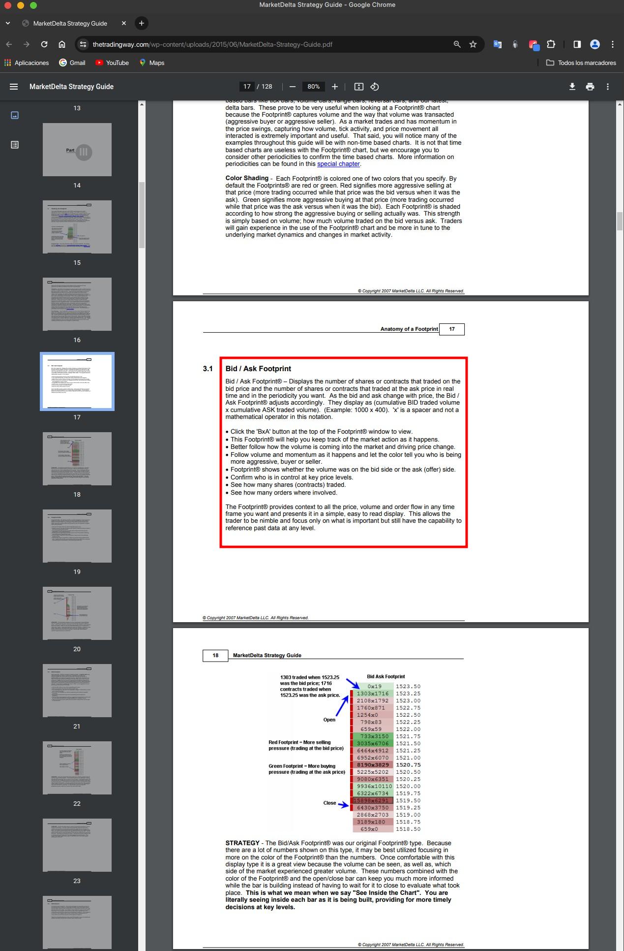

User805074 - Posts: 29
OK John, but the coloring of the bottom of the clusters is not based on the highs of the trading day, but takes them into account. The calculation is based on the delta, as did Market Delta, and today ATAS, CQG, the user whats1thingnow in the publication 144616, explains the method to do it. In my publication above I explain how I have done it, which is using Based on AskVol BidVol Difference - Actual, but for the coloration to be as close as possible to the attached image of ATAS, or CQG Market Delta, you must manually modify the values of Column 1 Actual Volume Compare Thresholds In:112 (if this column is used in the study), changing them according to the market and its trading volume, to match the attached image. It would be interesting if this option were automatic, when selecting the background coloring method, Based on AskVol BidVol Difference - Actual. Thanks.
imageMarketDeltaBidxAsk_Footprint2.jpg / V - Attached On 2024-01-10 09:37:00 UTC - Size: 282.07 KB - 282 views
imageMarketDeltaBidxAskFootprint.jpg / V - Attached On 2024-01-10 09:39:05 UTC - Size: 176.8 KB - 311 views
imageMarketDeltaBidxAsk_Footprint3.jpg / V - Attached On 2024-01-10 09:40:01 UTC - Size: 182.89 KB - 212 views
[2024-01-10 09:44:26]
In this post I am sending you the screenshots of the ATAS bar numbers, based on BidXAsk, the same as Market Delta. Thanks.
imageATAS_Footprint1.jpg / V - Attached On 2024-01-10 09:44:06 UTC - Size: 141.32 KB - 290 views
imageATAS_Footprint2.jpg / V - Attached On 2024-01-10 09:44:15 UTC - Size: 151.33 KB - 309 views
