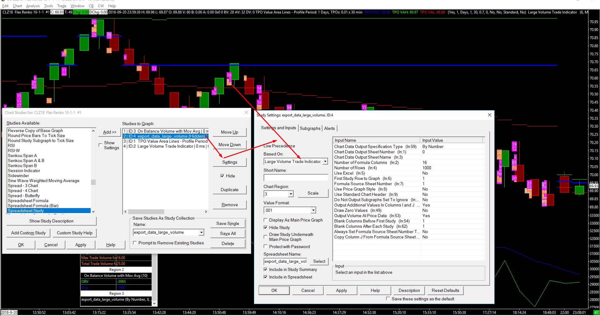

I am trying to export this indicator: Large Volume Trade Indicator
using Edit-->"export Bar and Study data to text file" but the data of the study is not exported altough other study data is exported.
pls advice

[2018-12-18 18:36:48]
This is because there is nothing to export. The data associated with the markers that are shown are kept internal and are not a Subgraph, therefore they would not be exported. Additionally, the two subgraphs that are associated with this study cannot be set to visible, therefore they also cannot be exported.
If you want to see the data behind the subgraphs, you can use the Spreadsheet Study and it will have the subgraph data in it. If you have problems seeing the information, then refer to this section of the documentation:
Using the Spreadsheet Study: Solving Study Not Displaying On Spreadsheet Sheet

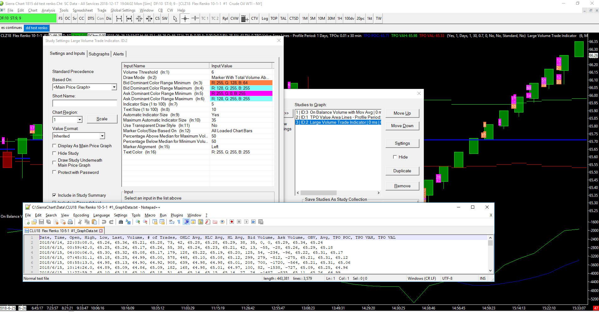

User61576 - Posts: 458
I must defined something wrong as although I added the spreadsheet study , I can not see the "Large volume study"'s data in the spreadsheet
pls advice.
thanks

[2018-12-20 18:17:05]
One thing we want to point out is do not base the Spreadsheet study on the Large Volume Trade Indicator. It should just be based on the main price graph.

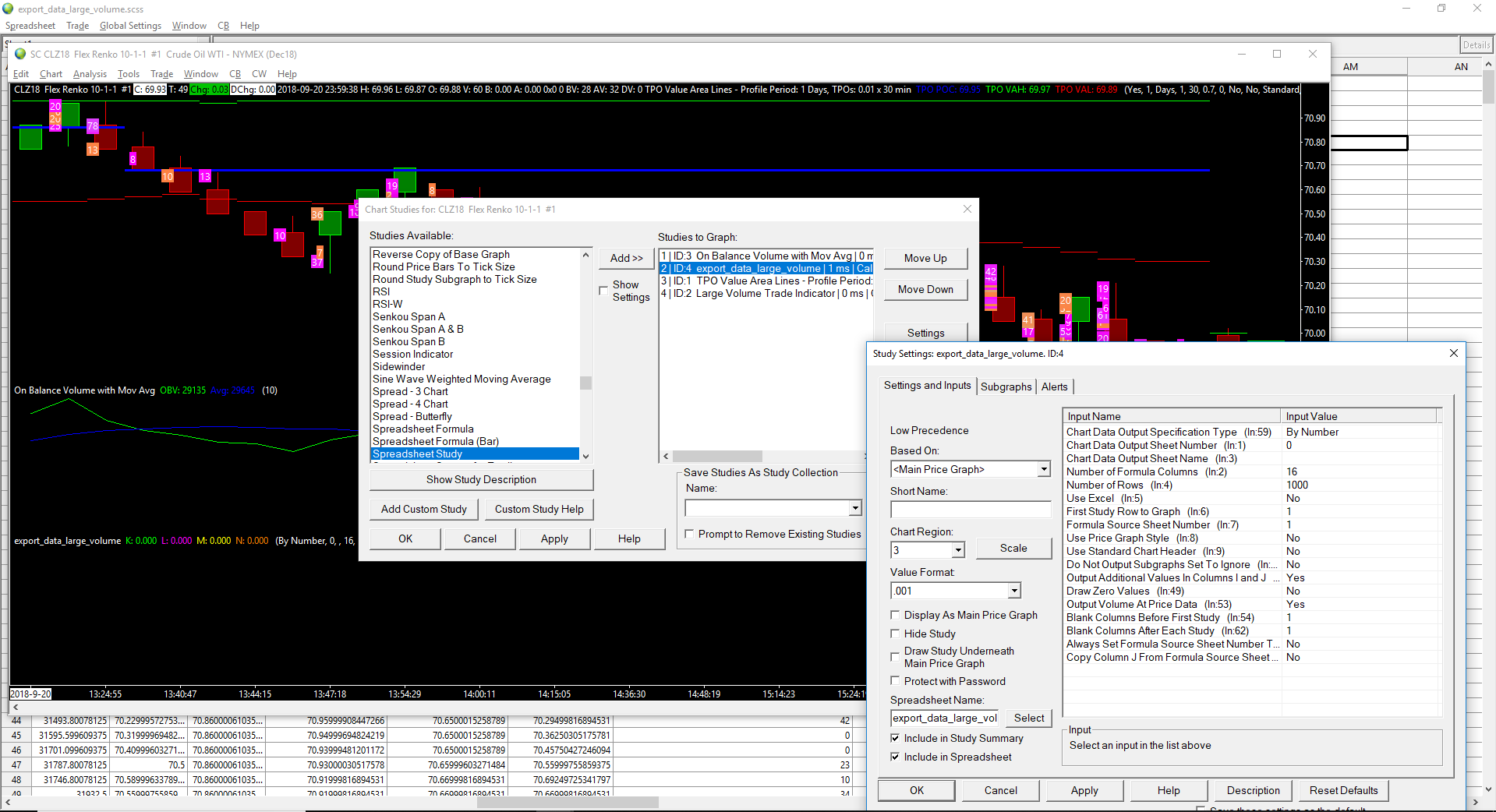

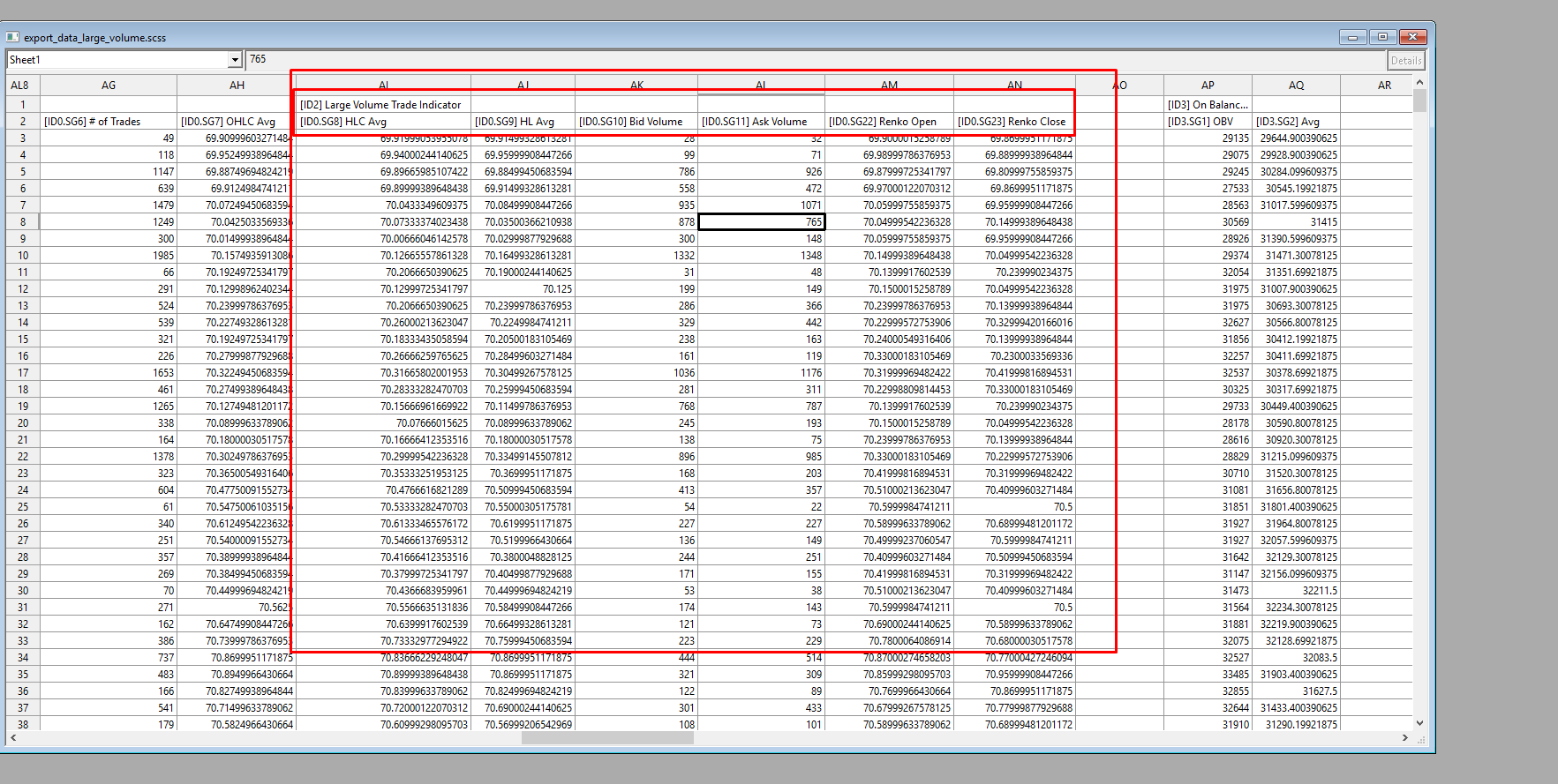

[2018-12-20 20:16:33]
changed as indicated to be based on the main price graph
and yet it's not being displayed on the spreadsheet.
pls check screenshots
you advice is needed again
thanks!

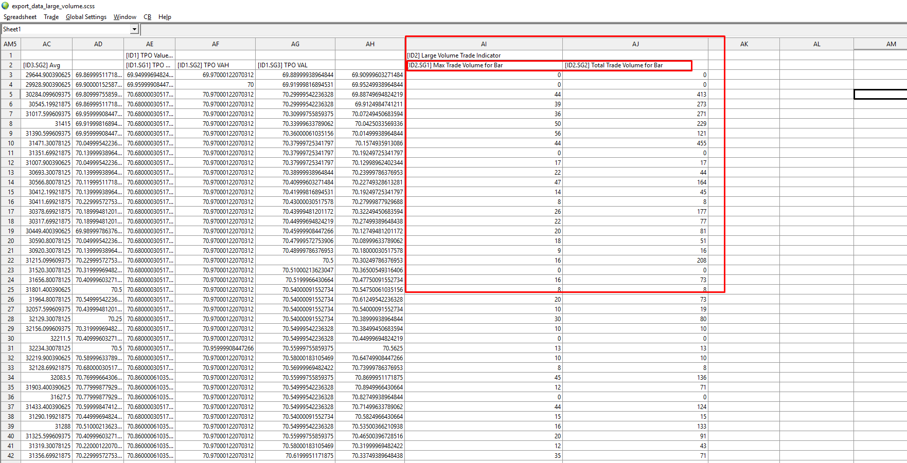

[2018-12-26 19:16:27]
We see the data here where you highlighted:
https://www.sierrachart.com/Download.php?Folder=SupportBoard&download=24610
If you are looking for any other data than what is currently displayed in those highlighted columns, that is not supported.
Also make sure the calculation order is correct:
Chart Studies: Study Calculation Precedence And Related Issues
