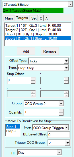

[2024-06-11 20:24:14]
User571402 - Posts: 1
Hi guys! :D
Im trying to follow up on kind of this question. Im trying to make stop-loss for OCO 1 and 2 move to breakeven when my first target is triggered. But i cant seem to make the SL move. Can you check out this picture and help me with my settings? :D
Regards Sebbe
EDIT!
In case anyone needs and were as stupid as i were. I had put OCO group 2 on second stoploss. This should be OOC 1 since its when first target triggers (Target 1 = OCO grp 1) my stop should be moved.
BTW! Sierra, you've done nothing but wonders. By far the best plattform out there in every way! Answers for everything. Customizable by max. Cheers guys
Date Time Of Last Edit: 2024-06-11 20:30:28

[2024-06-12 17:44:43]
ForgivingComputers.com - Posts: 1254
The Stop for OCO 1 will be canceled when Target 1 fills.
For Stop 2, change the Trigger OCO Group to 1.
Date Time Of Last Edit: 2024-06-12 17:45:50
