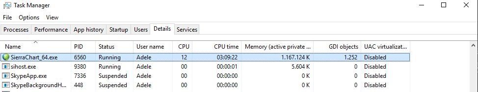

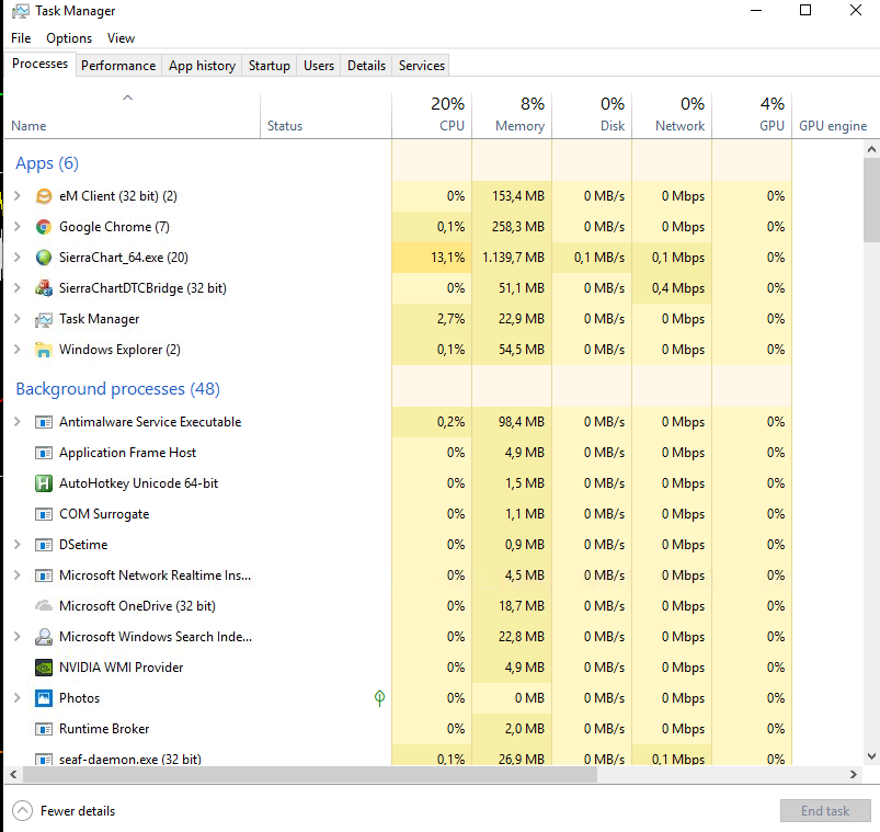

Hello SC,
i am running SC on an 8 monitor setup and its really behaving slow, even though there is not a whole lot of cpu / gpu usage...
is there a way to find out whats causing that issue?
i have attached my chartbook, cpu as well as gdi count...
please advise
Date Time Of Last Edit: 2018-11-26 16:10:06
imagecpu_usage.png / V - Attached On 2018-11-26 16:03:51 UTC - Size: 89.26 KB - 722 views
imagegdi_objects.png / V - Attached On 2018-11-26 16:03:55 UTC - Size: 31.79 KB - 735 views
Private File

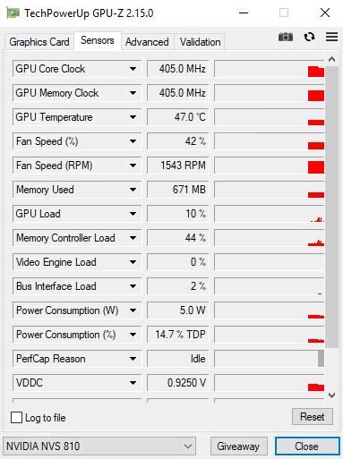

[2018-11-26 16:10:47]
Cavalry3162 - Posts: 523
here's the gpu load.. which alternates between 3% and 10%
imagegpu_load.png / V - Attached On 2018-11-26 16:10:31 UTC - Size: 44.19 KB - 538 views
[2018-11-26 21:09:03]
Most likely the issue is due to the high GDI Object count. Not sure why it is so high. It could be due to Fonts. The first step is we need to make sure the number of Fonts is limited and we will do that in the next release and then you can see if that helps bring the GDI Object count down substantially.
[2018-11-26 21:19:00]
that sounds like a plan..

SC, anything?
[2019-07-10 04:51:30]
We are testing the Chartbook now to see what GDI count we see.
[2019-07-10 17:57:36]
We are working on the issue of the high GDI count.
Date Time Of Last Edit: 2019-07-10 17:57:54
[2019-07-10 18:17:38]
that sounds great.. however, GPU load isnt exactly high.. could the gdi count still slow things down even though the gpu has plenty of room?
thanks,
Andreas
[2019-07-10 22:57:45]
The GDI count is just too high. Windows is not handling this well. If it is over 500, this is not good and yours is over 1000.
[2019-07-14 03:59:30]
In the next release there is going to be a reduction of the GDI count, but we have discovered another reason for the high GDI object count.
The reason has to do with all of your detached charts have their own control bar and some of those control bar items use graphics rather than text and each of those graphics is a separate bitmap object.
If you disable the control bars on the detached charts and find you have a significantly reduced GDI count and then improved performance, then this really proves just how totally and completely abysmal and poorly designed the Windows operating system is in regards to GDI objects.
This is beyond comprehension that having a significant number of bitmaps allocated is causing such a problem. It should cause zero performance impact. There really is no other way to say this than the Microsoft engineers who worked on this are complete dummies. And the fact that they have not even taken care of this to this day is shocking.
Please do let us know if removing the control bars from detached charts improves performance significantly. If so we will then add this to our list of items which can cause high CPU usage. And it is the buttons which use graphics which is the problem. If a Control Bar button is just plaintext it is not a problem.
Date Time Of Last Edit: 2019-07-14 04:30:28

SC,
thank you for taking the time and discover this. i obviously do not have a performance impact yet but disabling like 10 control bars (all i had in my current chartbook) certainly decreased the number of gdi objects by almost 30% from 1041+268 to 780+182 (i have 1 main SC and 1 instance running, in an attempt to increase performance, which didnt actually work out)
i will report on monday how this is behaving in real life and if there's any improvement.
i am also looking forward to your next release to see if there's an additional reduction in gdi objects as well as a noticable improvement performance wise.
i have attached my latest 2 chartbooks (1 for each instance i am running) just in case..
Andreas
Date Time Of Last Edit: 2019-07-14 08:38:59

imageSC_GDI_after.png / V - Attached On 2019-07-14 08:19:05 UTC - Size: 21.79 KB - 487 views
