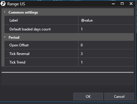

There is a specific Number bar chart that I want to duplicate. Specifically the trending / reversal specifics. I have tried to play with the range bar and reversal bar settings, but I can't get exactly what I need.
If there is anyone who could put the specific (3) charts together for me I would appreciate it.
Attached are the screen shots of the 3 charts, and the range/reversal settings.

Picture 2 shows:
The range chart settings.
image3 charts.jpg / V - Attached On 2018-11-19 02:04:11 UTC - Size: 254.89 KB - 489 views
imageRange setting.jpg / V - Attached On 2018-11-19 02:04:32 UTC - Size: 23.96 KB - 419 views

I believe the setting I am looking for are somehow possible with flex renko or inverse flex renko.

I figured it out. It was a inverse flex renko. "they" sell it as a super algorithm that a prop trader came up with. Settings are secret.

Yes those settings do look like Flex Renko bars. Refer to:
Renko Bar Charts
