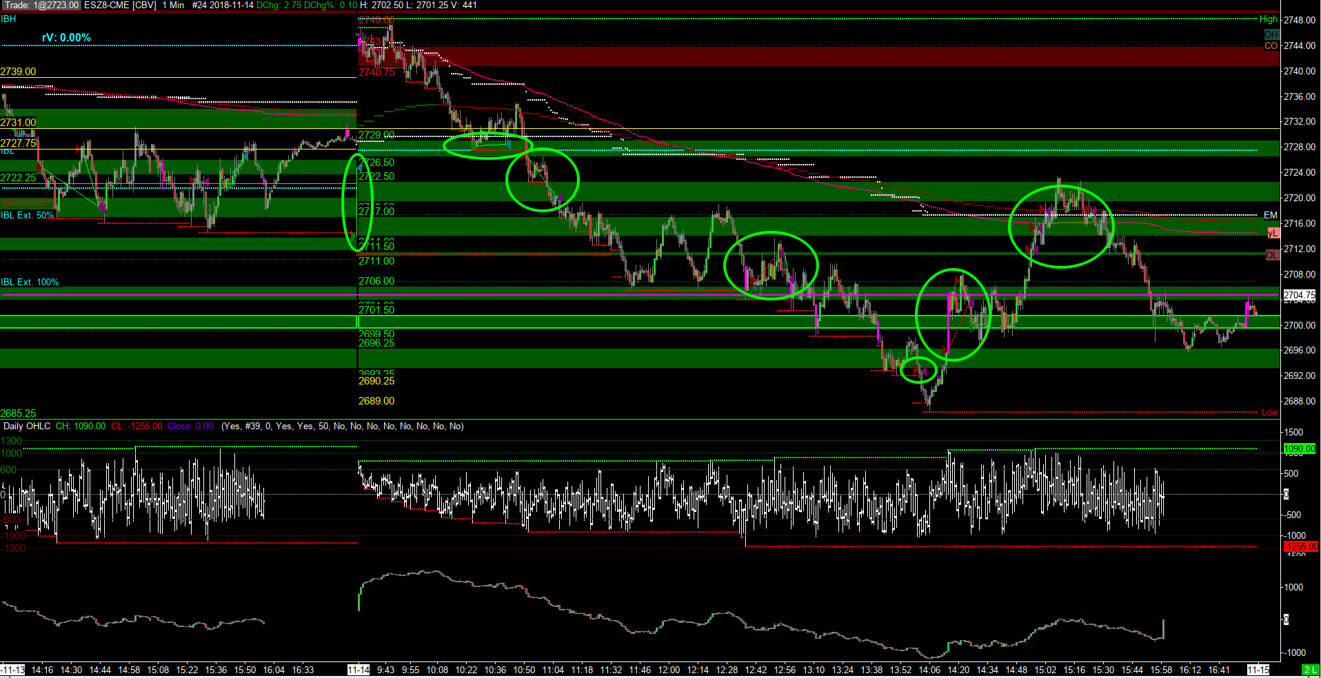

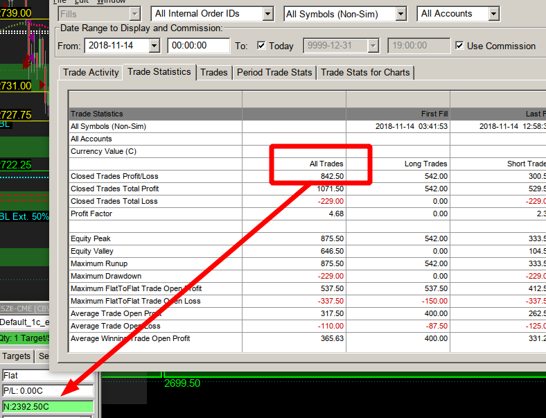

1. P&L calc shows weird things in the trade window while it calcs correctly in the trade activity log... it gets weirder trade by trade..
2. it does not draw order connecting lines.. i see the triangles but no lines and yes they are enabled.
see screenshots
thanks,
Andreas
imagePnL_issue_sc.png / V - Attached On 2018-11-14 18:18:51 UTC - Size: 199.98 KB - 495 views
imagePnL_issue_2_sc.png / V - Attached On 2018-11-14 18:18:55 UTC - Size: 79.87 KB - 606 views
imageposition_line_issue_sc.png / V - Attached On 2018-11-14 18:18:59 UTC - Size: 43.88 KB - 469 views

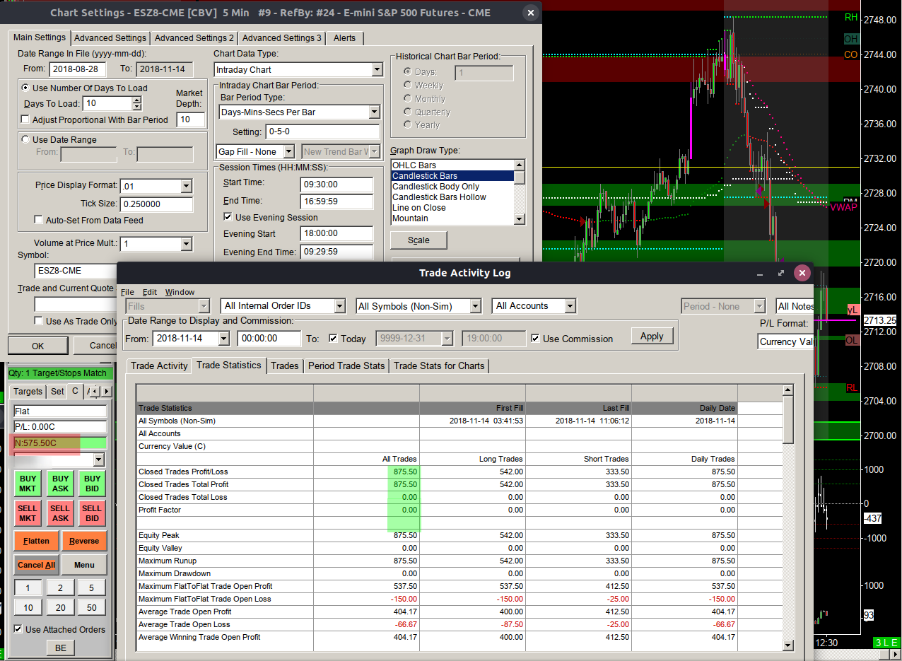

but while i was working on it i figured that all "dot" drawing styles are not working while solid lines seem to work..
at the same time i figured why the P&L calc is screwed... see attached screenshot, it does some wild trade matchings which dont seem to change when i switch to another fill matching mechanism..
is there a way to fix that?
imagescreenshot_5.png / V - Attached On 2018-11-14 21:26:41 UTC - Size: 87.28 KB - 484 views

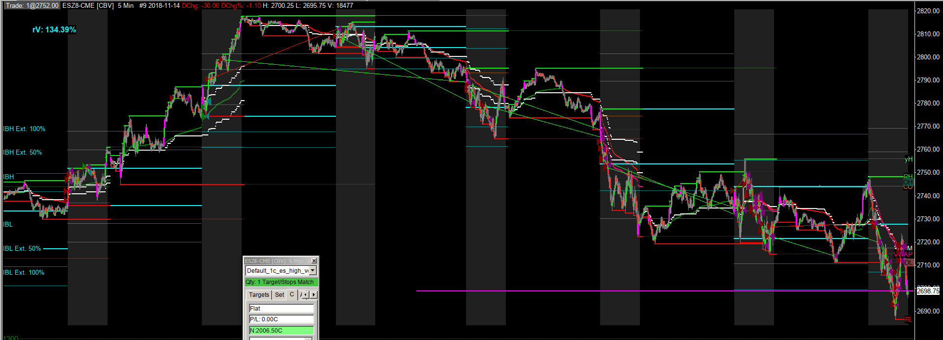

Cavalry3162 - Posts: 523
please look at the rth chart.. its a 1min day session only chart from the same time period which shows all my trades correctly..
though at the same time that 5min 24h session chart from above (i've attached it again as eth_wrong) shows me weird fills and thinks i have carried on any positions from the prev day, which i have not coz i am flat when the market closes..
so it CAN NOT BE that there are carried over positions from yesterday. the rth chart doesnt show them either, which it should if there were any...
i dont want support, i want you to fix the issue or tell me whats wrong with your software.
imagetrades_issue_rth_correct.png / V - Attached On 2018-11-15 09:18:36 UTC - Size: 118.95 KB - 446 views
imagetrade_issue_eth_wrong.png / V - Attached On 2018-11-15 09:18:58 UTC - Size: 87.28 KB - 457 views

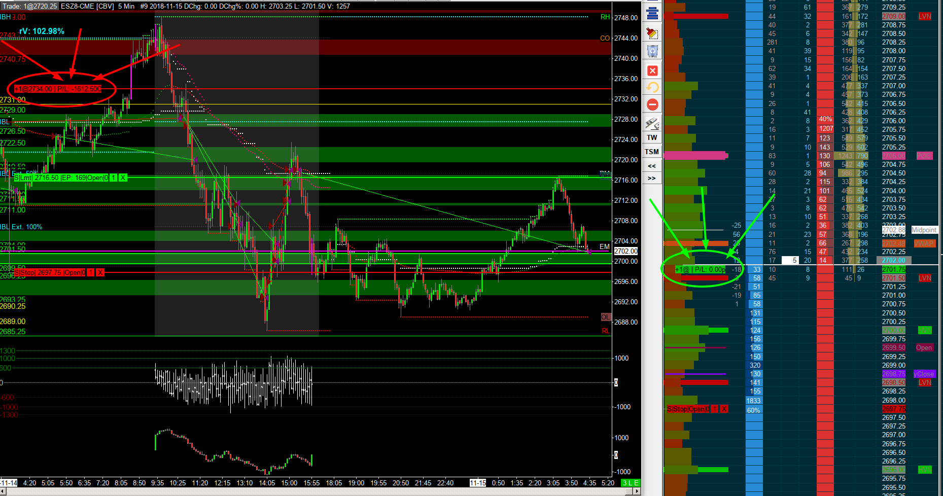

another funny thing just happened..
i entered long on my dom and now the 24h chart thinks i am long from like 30 handles higher..
see screenshot
imagetrade_issue_dom_vs_chart.png / V - Attached On 2018-11-15 09:36:28 UTC - Size: 243.99 KB - 389 views

In regards to post #6 you need to make sure that the Order Fills Start Date-Time is the same between those two charts:
Chart Settings: Order Fills Start Date-Time (Chart >> Chart Settings >> Trading menu)
And that they use the same Open Position Quantity Average Price calculation method:
Chart Settings: Open Position Average Price (Chart >> Chart Settings >> Trading menu)
This is point-blank simple to resolve assuming there are no missing order fills for the current position.

We realize the instructions at step 21 here were not necessarily going to work in all cases when trying to get a match with the Daily Profit/Loss between a chart and the Trade Activity Log. A better explanation has been given:
http://www.sierrachart.com/index.php?page=doc/DailyProfitLossValue.html
Refer to step 21.
And also the screenshot is not following the instructions in that documentation:
https://www.sierrachart.com/Download.php?Folder=SupportBoard&download=23583
For example you still have the Use Commission setting enabled and you did not select a particular Symbol and Trade Account. These last two items, are a major item and why you cannot expect to have a match.
You should also select to display the PL in Points both on the chart and the Trade Activity Log to remove additional complexity with potential inconsistent settings like the Currency Value per Tick.
