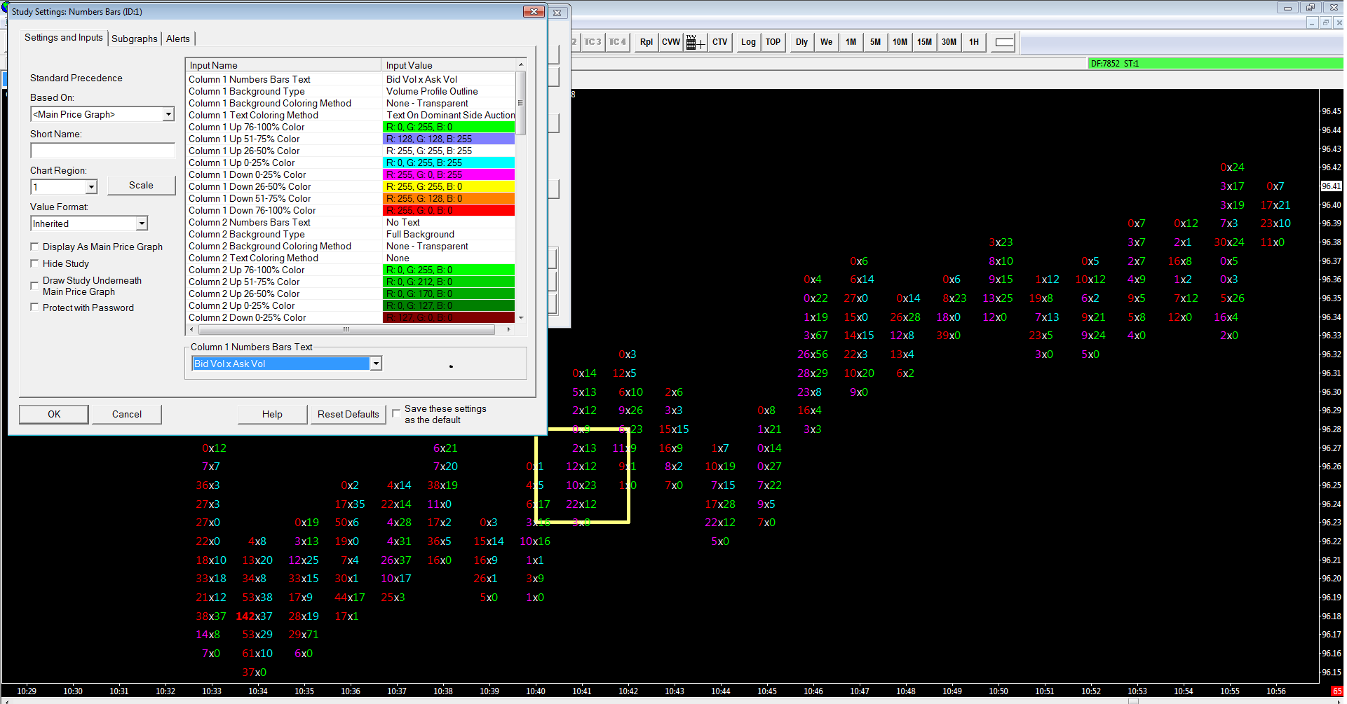

At bar time 10:41 on 10-31-13 the coloring feature for the Column 1 UP % only seems to work with the 75-100%, which seems to defy the logic of the auction #’s. Is this a bug or do I have something set up incorrectly? I'm using default Column 1 threshold percentages.
http://www.sierrachart.com/image.php?l=1383451861195.png

The documentation for the Text Coloring Method Input is here:
http://www.sierrachart.com/index.php?l=doc/doc_NumbersBars.php#TextColoring
Refer to the description for Text on Dominant Side Auction.
The coloring should be according to the documentation. Please examine and understand it. If it is not working as documented, we would need to get your Chartbook and a specific explanation.

OK, I examined the documentation in great detail and understand better how you have this set up. According to the instructions, you have the coloring interrelated such that:
BV < AV = BV Down 0-25%
AV > BV = AV UP 76-100%.
When looking at the numbers in my screenshot (square highlight) the auction numbers on the dominant side are 13, 12, 23 which are not 76-100% greater than 12, 10, 22. However 12, 10, 22 are 0-25% less than 13, 12, 23 making it appear as though it is coloring the non-dominant side with precedence.
The way I think of it is that dominant side should be the one with the greater volume and be colored based on its percentage UP or Down from the weaker volume number.
