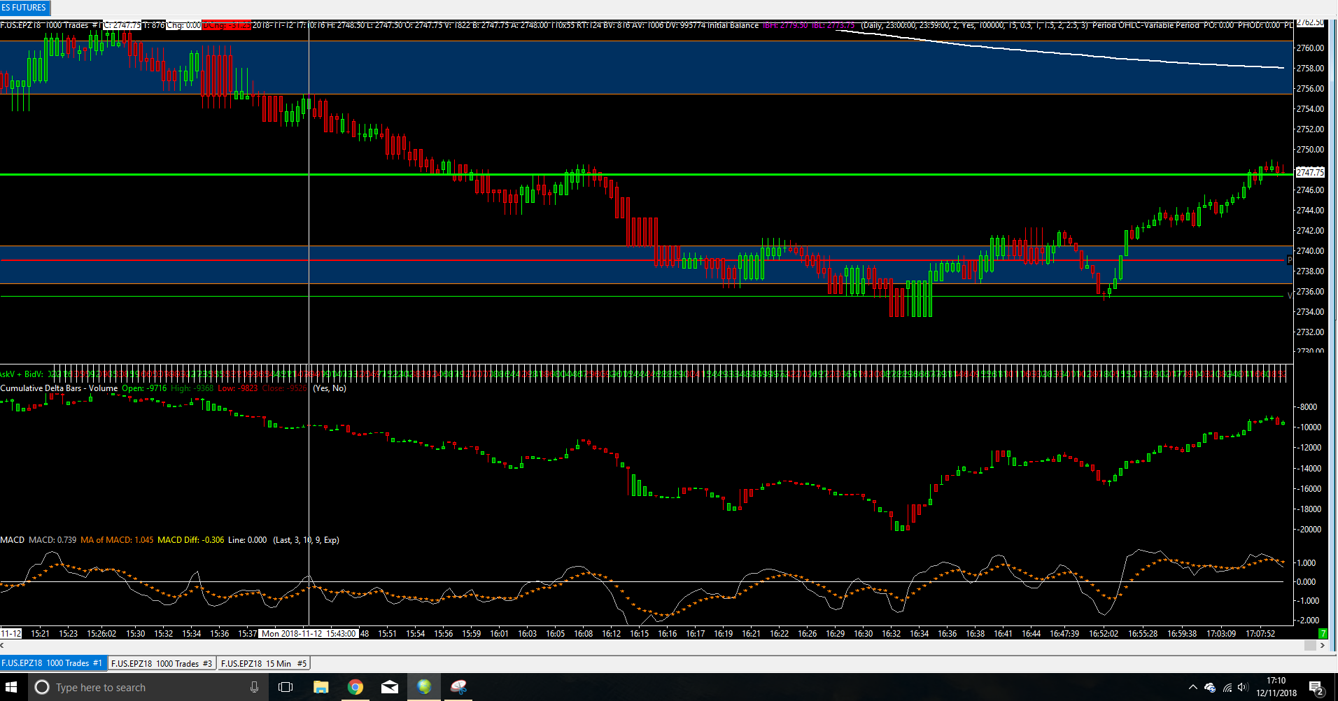

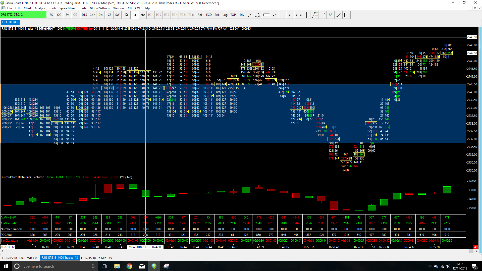

Hi Sierra, any ideas why my tick chart is looking like this on F.US.EPZ18. It has a setting of 1000 ticks on intraday chart, normal candlestick bars. Ive gone onto replay to see how the bars develop as sometimes they last for 1 minute but price doesnt even fluctuate within the candle as its being created, it just opens and then after a minute, closes and opens on the next bar, nothing in between. But then later in the session as you can see at 16:47, candles have normal volume, and trade 'normal' again and price fluctuates within the candle as its being created?
I went onto decemeber 2018 CL as well and it is the same. However on the November contract there is no signs of this kind of action. Very strange.

[2018-11-12 19:19:59]
Set Sierra Chart to a Tick by Tick Data Configuration. Follow the instructions here to do this:
[2018-11-12 19:41:46]
tarik medjber - Posts: 13
Thats amazing, thankyou. For some reason going through the steps again has worked however I already had the settings correct so maybe it was the 'Edit >> Delete All Data And Download' part but thankyou veyr much. SC has the best support. Thanks again
