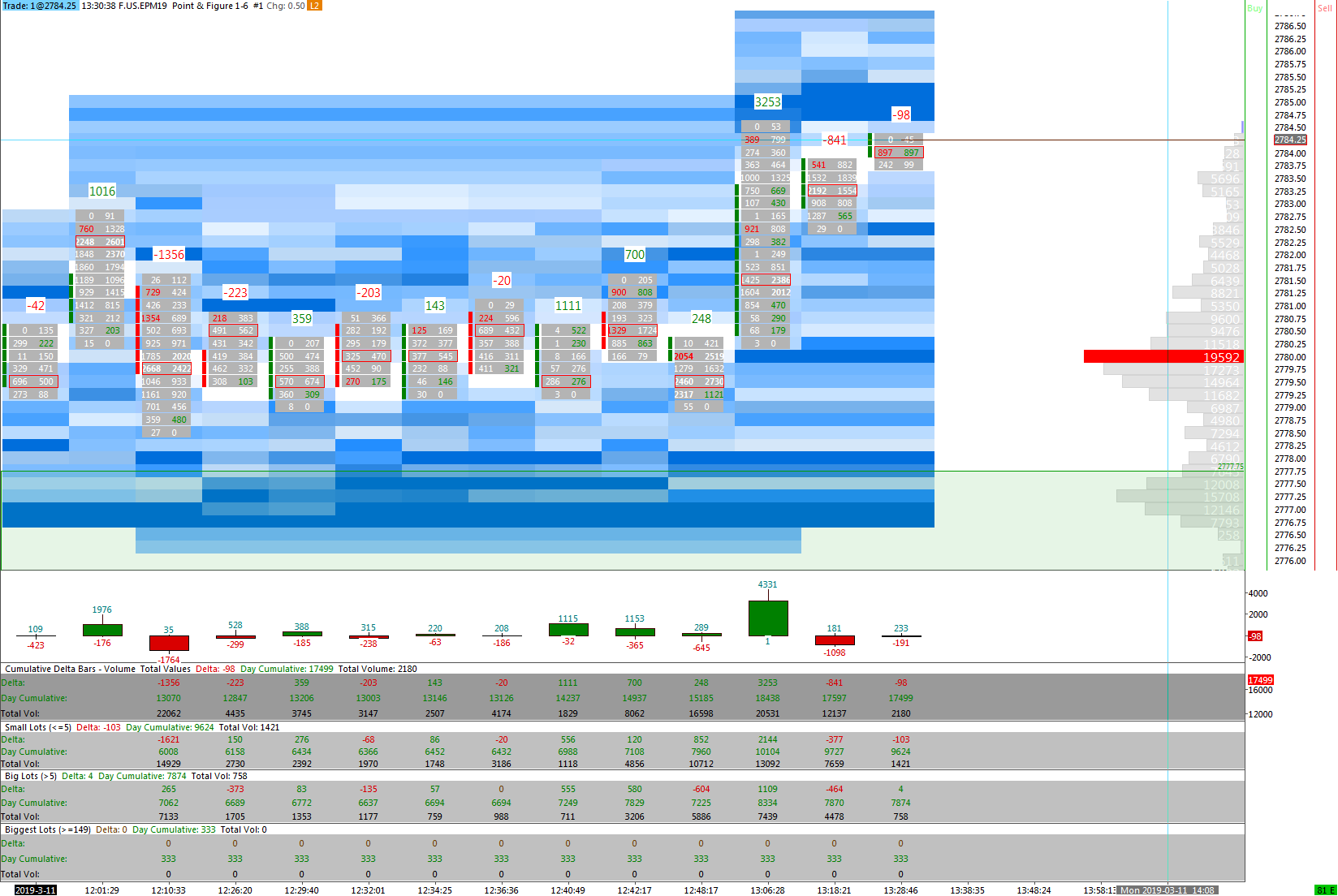

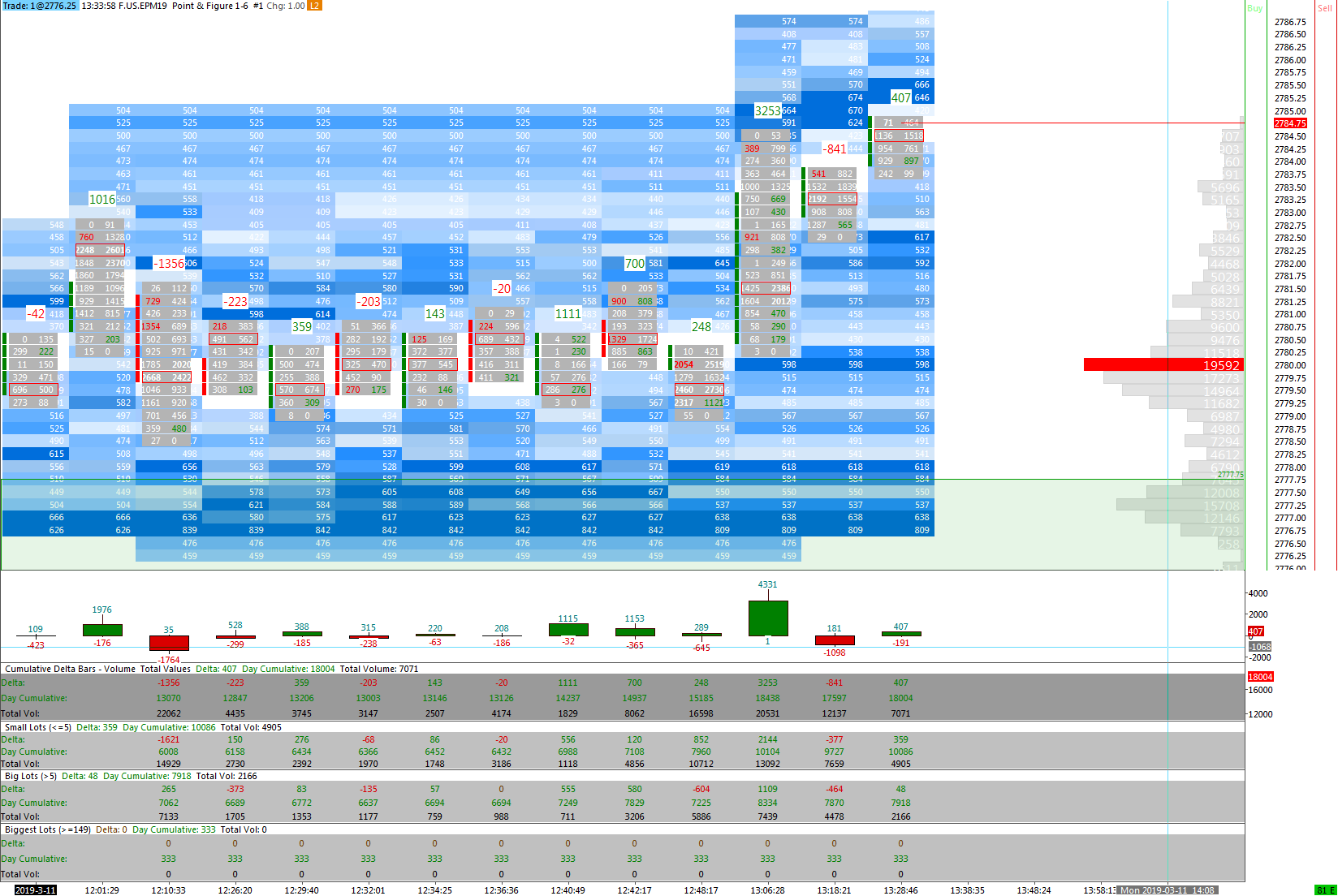

AKR - Posts: 543
I have added the MDHG to a number bars chart. when I use "display only after last bar" I dont see any figures.
If I dont use it it is completely confusing (see charts attached) and it would also be sub optimal if the quantities where shown in the actual column (should be a bit to the right).
am I doing something wrong? If so what, if not can it be adjusted?
imageF.US.EPM19 Point & Figure 1-6 #1 2019-03-11 18_33_59.573.png / V - Attached On 2019-03-11 17:35:13 UTC - Size: 188.47 KB - 479 views
imageF.US.EPM19 Point & Figure 1-6 #1 2019-03-11 18_30_38.322.png / V - Attached On 2019-03-11 17:35:19 UTC - Size: 123.13 KB - 485 views
[2019-03-11 18:13:27]
John - SC Support - Posts: 48317
The option to display the Quantity values after the Last Bar only works when the option for Display Market Depth Quantities After Last Bar is set to Yes. These two settings are linked together. This is explained here:
Market Depth Historical Graph: Show Quantity Numbers
Keep in mind the option for Display Market Depth Quantities After Last Bar is only displaying the values for the most recent bar. The documentation for this setting is here:
Market Depth Historical Graph: Display Market Depth Quantities After Last Bar
