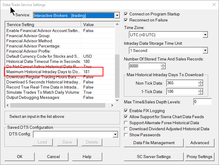

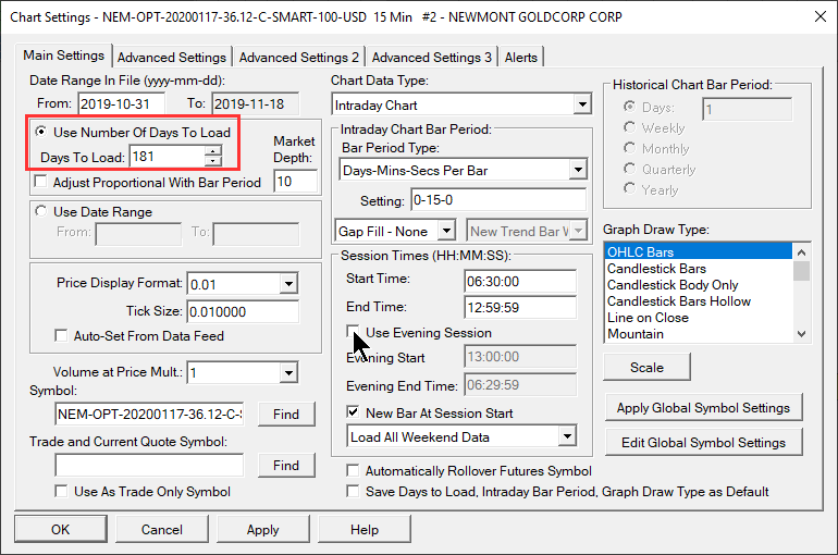

[2019-11-18 22:42:10]
U536222 - Posts: 40
As far as I can tell, these are already set correctly as per the attached screenshots.
image2019-11-18 14_36_20-Chart Settings DAYS TO LOAD - NEM-OPT-2.png / V - Attached On 2019-11-18 22:40:05 UTC - Size: 40.08 KB - 418 views
image2019-11-18 14_36_01-Data_Trade Service Settings - INTRADAYS.png / V - Attached On 2019-11-18 22:40:22 UTC - Size: 37.14 KB - 405 views
[2019-11-19 18:51:02]
Yes you do have the correct settings. We cannot provide any further help. We have a very clear support policy on this:
Interactive Brokers Trading Service: Support Policy Regarding Interactive Brokers Historical Data
Date Time Of Last Edit: 2019-11-19 18:51:12
