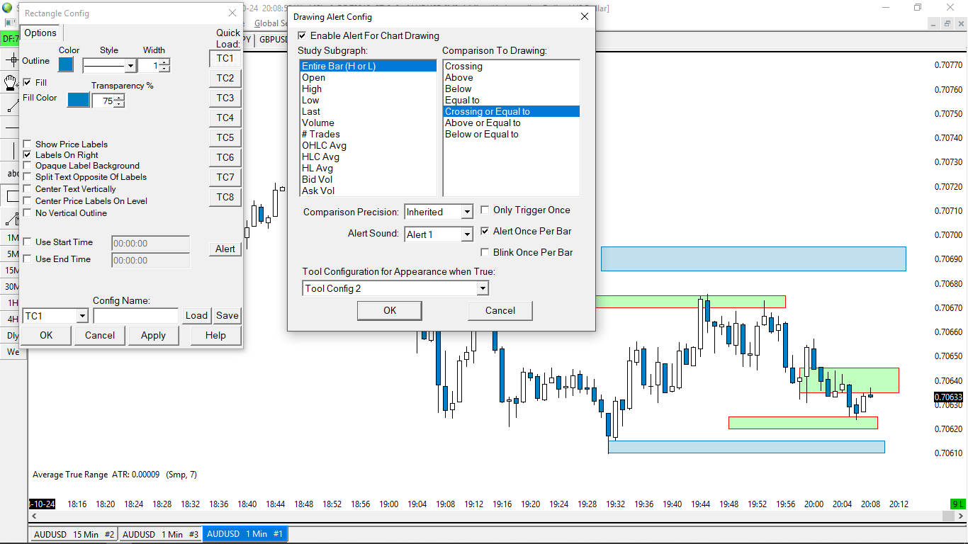

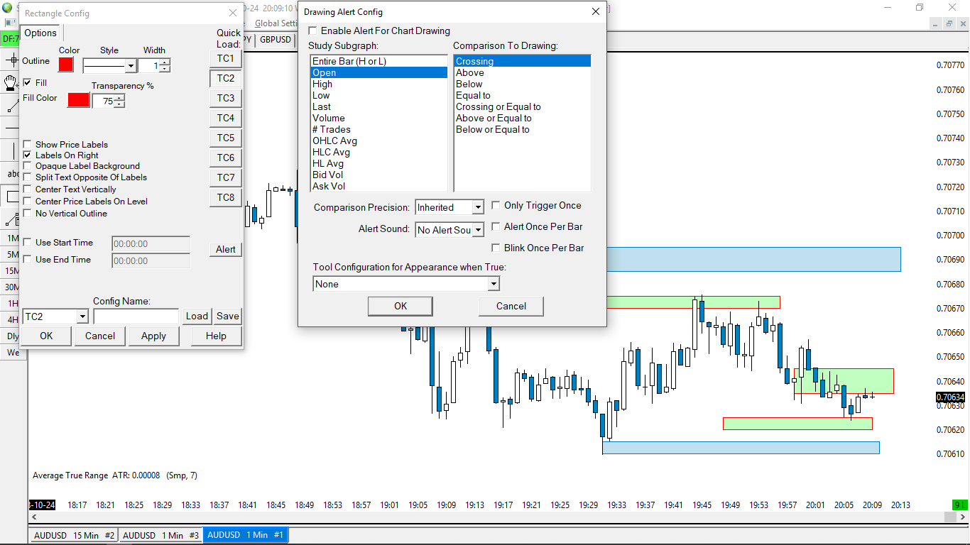

So, when I open the rectangle drawing alert config and set the color to change when the alert is true,then the color changes, but not the specified one.When I set the same for horizontal line or other,then it is working.Can You help me plz!Thank You!
imageKépernyőfelvétel (2).png / V - Attached On 2018-10-24 18:10:21 UTC - Size: 94.9 KB - 434 views
imageKépernyőfelvétel (3).png / V - Attached On 2018-10-24 18:10:27 UTC - Size: 93.78 KB - 370 views

John - SC Support - Posts: 48526
We found the problem and have fixed it. It will be in the next release.
It was using the Extending Rectangle's Configuration Files for the Rectangle alerts.
