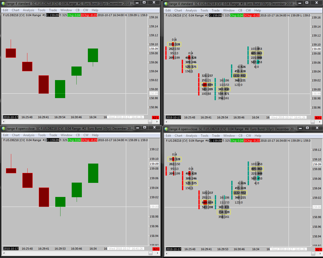

Hello, I am a bit confused about the formation process of the Range Bars (Open = Close).
The screenshot above shows a chart with "Range Per Bar - Standard(in ticks)" (Setting: 4) and below with "Range per Bar - Open = Close" (Setting: 4). The marked bars have different Volumes and POCs.
Why does the right red bar only have 4 ticks using "Range Per Bar - Open = Close" compared to other bars in this chart and the "Range Per Bar - Standard(in ticks)" chart?
How is the transition from one bar to the next?

Duplicate the chart and remove the Numbers Bars study, do you then see the proper range? If so, then it must be a case where the market trading activity gapped by a tick or more.
[2018-10-17 21:34:14]

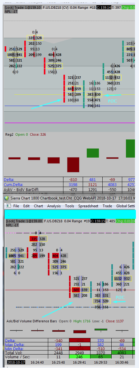

Marc@SC - Posts: 13
I know the documentation, but there is no explanation for that behavior.
left side: I removed all studies in the "Range Per Bar - Standard(in ticks)" (Setting: 4) chart, duplicated the chart and set to "Range per Bar - Open = Close" (Setting: 4).
right side: with study Numbers Bars.
The result is the same.
Date Time Of Last Edit: 2018-10-18 05:34:06
imagedifference_RangeBar 3.png / V - Attached On 2018-10-18 05:32:06 UTC - Size: 116.52 KB - 502 views
[2018-10-19 14:39:55]
John - SC Support - Posts: 48526
Most likely this is because of New Bar at Session Start. Refer to the documentation here: Chart Settings: New Bar at Session Start (Chart >> Chart Settings >> Session Times >> Intraday Chart Session Times menu)
