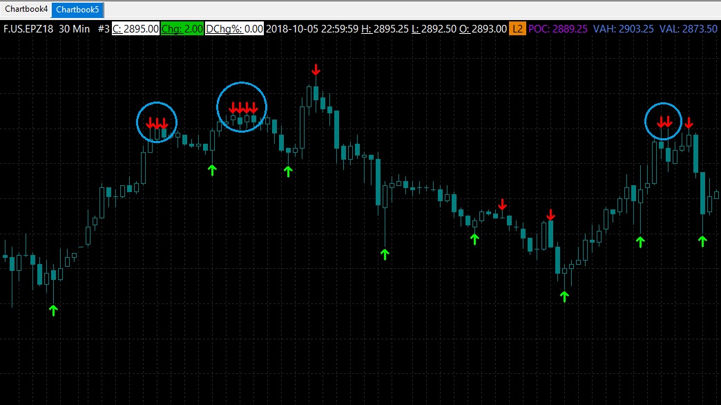

Hello!
I'm using Swing High and Low study.
Is it possible to display only one arrow at swing highs or lows when nearby bars are of the same size?
Also, is it possible to display the value of the swing high/ low right above or below the arrow?
Please see the attached screenshot.
Thanks!

[2018-10-08 17:30:36]
Try setting the "Allow Equal High/Low Bars" Input to No if it is not already.
This is not supported.
[2018-10-08 17:31:25]
With regards to
be sure the Input setting for the Equal High/Low Bars is set to No. You will find the documentation here: Swing High and Low
With regards to
, use the following study: Study Subgraph Above/Below Bar as Text
You will need two of these studies, one for the Swing High and another for the Swing Low. You will need to offset the display of the text using the Input Setting Offset in Ticks to move it above/below the arrows.
