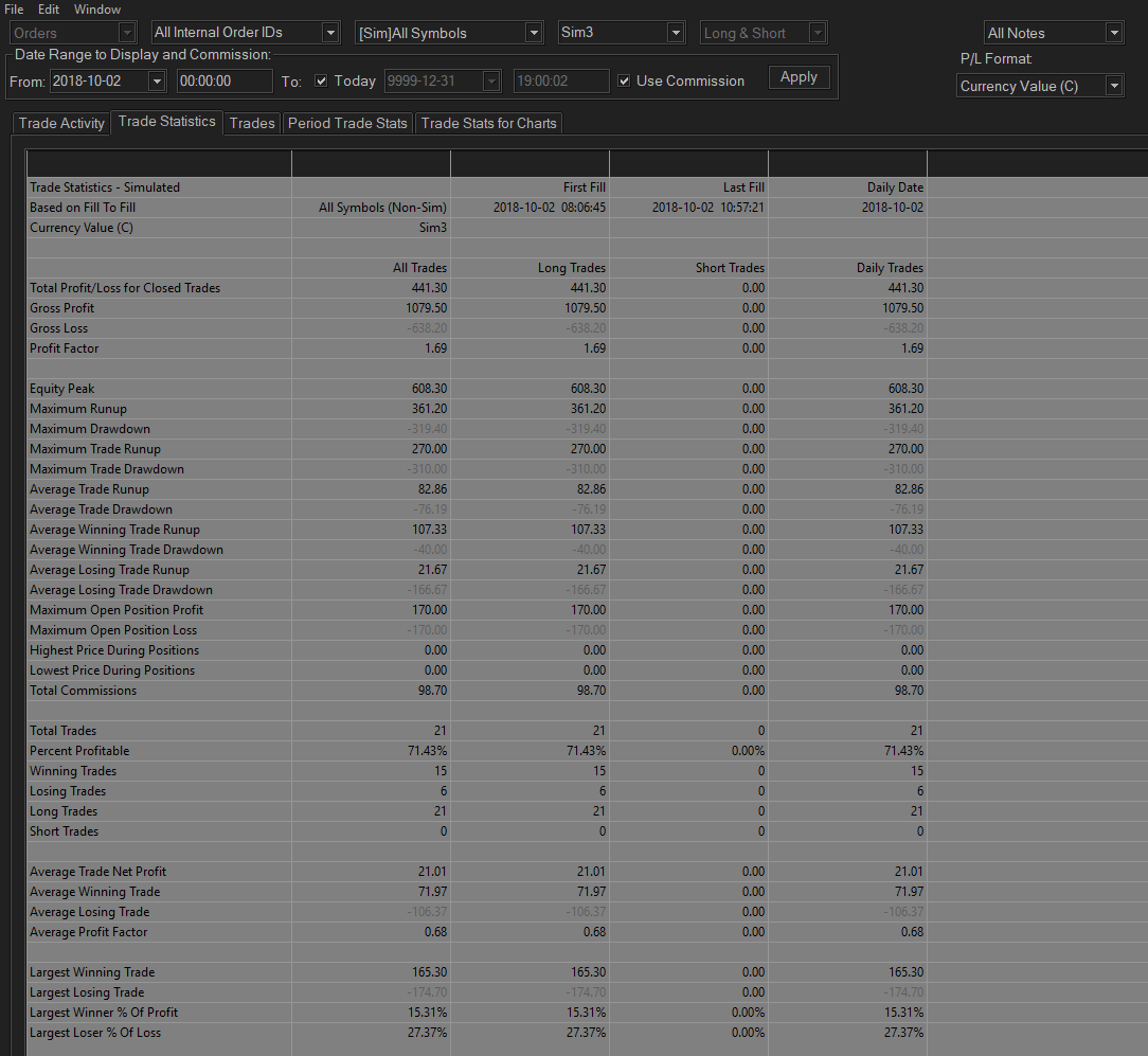

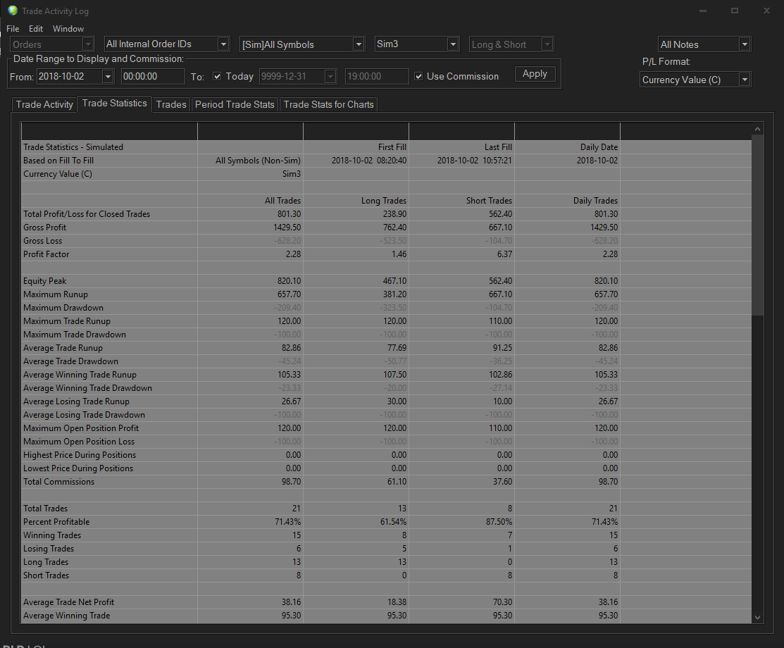

User522029 - Posts: 1
Also i'd two issues with SC 1811 and 1815.
Title: Trade activity SIM accounts data corruption and non-functioning import.
Reference images are shared here: https://imgur.com/a/75tPtxd, and also attached to the post.
- Image1: SC1811 : Sim3 : TradeActivityLog : Shows correct fills and times. (PASS)
- Sim4 account shows correct stats to. (PASS)
Upgrade to 1815
- Image2: SC1815 : Sim3 : TradeActivityLog : Shows in-correct fills, times and stats. Short trades aren't shown properly. (FAIL)
- Similar issue with Sim4 account. (FAIL)
Selecting a single date 2 Oct 2018.

[2018-10-03 08:42:37]
Upgrade to 1815
We do not observe this and see no reason why there would be a problem like this. We would need to get your Trade Activity Log file and have a look. Instructions:
Trade Activity Log: Providing Trade Activity Log File to Support
And it is always a good idea to choose a particular symbol at the top of the Trade Activity log rather than using All Symbols. There is a lot of associated complexity when using all symbols and potential for calculation errors due to different currencies and missing Symbol Settings.
