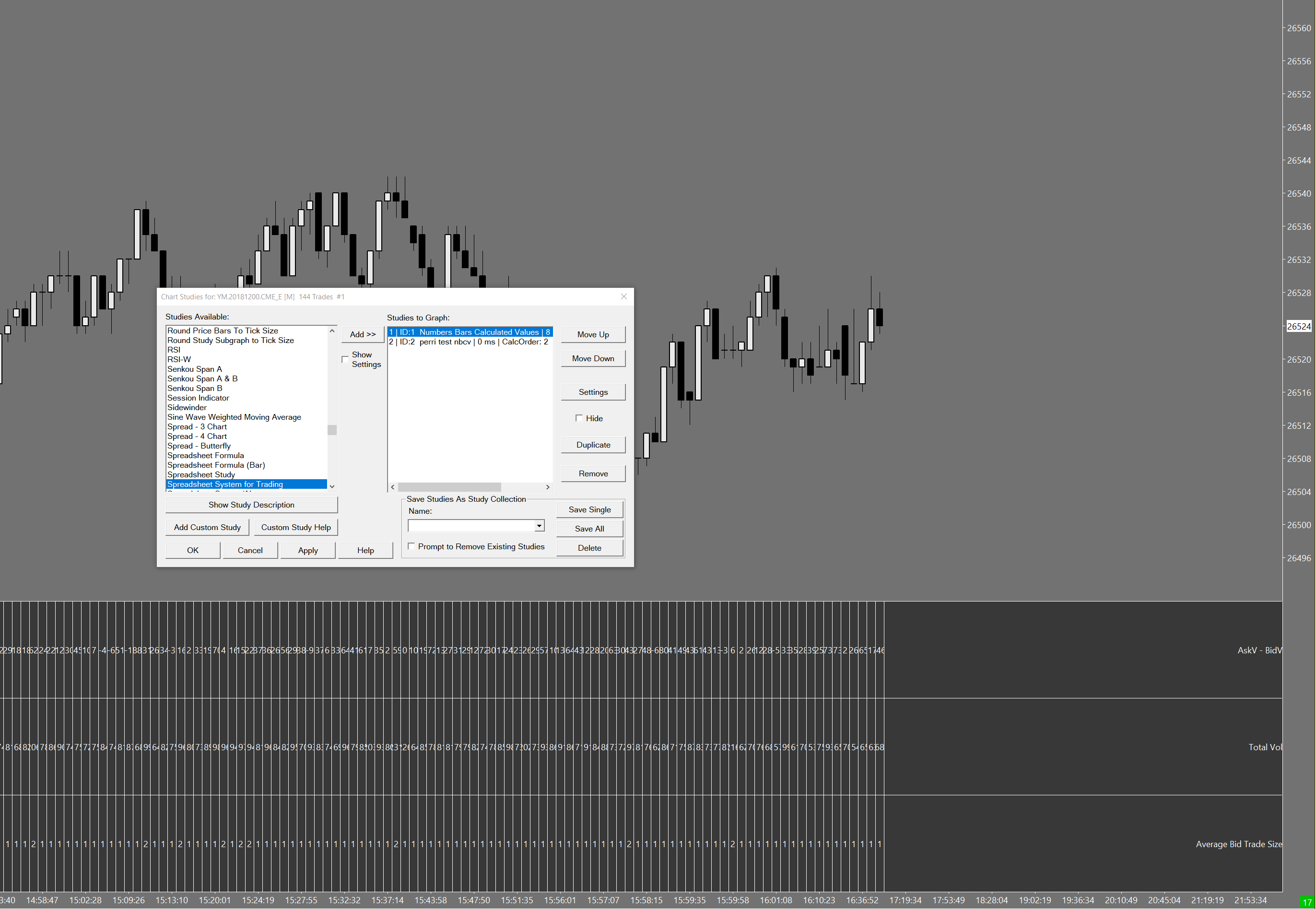

Currently have a chart with Numbers Bars Calculated Value(ID 1) attached with 4 subgraphs visible. When i then attach a Spreadsheet for trading study, i do not see id:1 (NBCV) in the expected AA column.
Not sure why as i have previously used the NBCV study within spreadsheets. Perhaps there is a new setting? Any insight would be appreciated.

User809700 - Posts: 14
Hi Tom,
Yea, its kind of weird . . . i am currently on sierra version 1809.
Only two studies: id1 is NBCV (3 subgraphs visible), id2 Spreadsheet for trading.
I have even added other studies above the spreadsheet for trading and they do appear in AA, so the "issue" must be with NBCV . . . <headscrating>
imagenbcv.png / V - Attached On 2018-09-25 21:49:37 UTC - Size: 149.14 KB - 480 views

[2018-09-26 16:08:40]
John - SC Support - Posts: 48526
Refer to the following: Using the Spreadsheet Study: Solving Study Not Displaying On Spreadsheet Sheet
Be sure you have the Subgraphs that you want to show up in the Spreadsheet set to Include in Spreadsheet.
[2018-09-28 23:17:27]
This worked...Thanks Sierra and Tom
