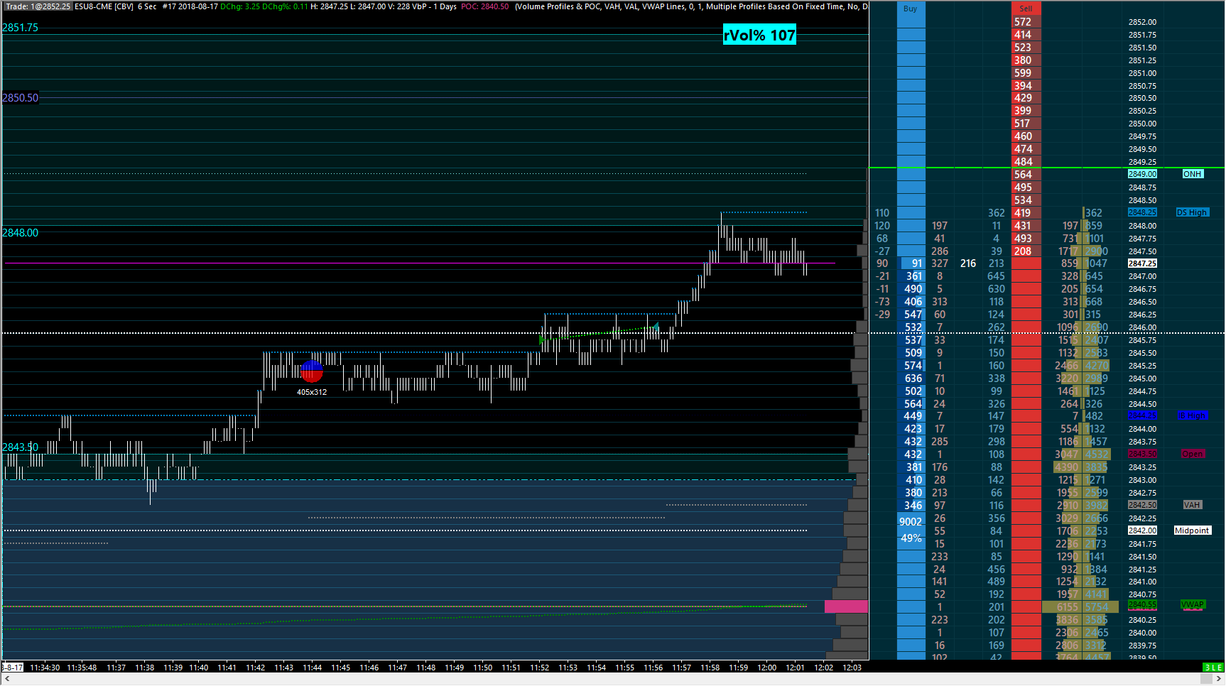

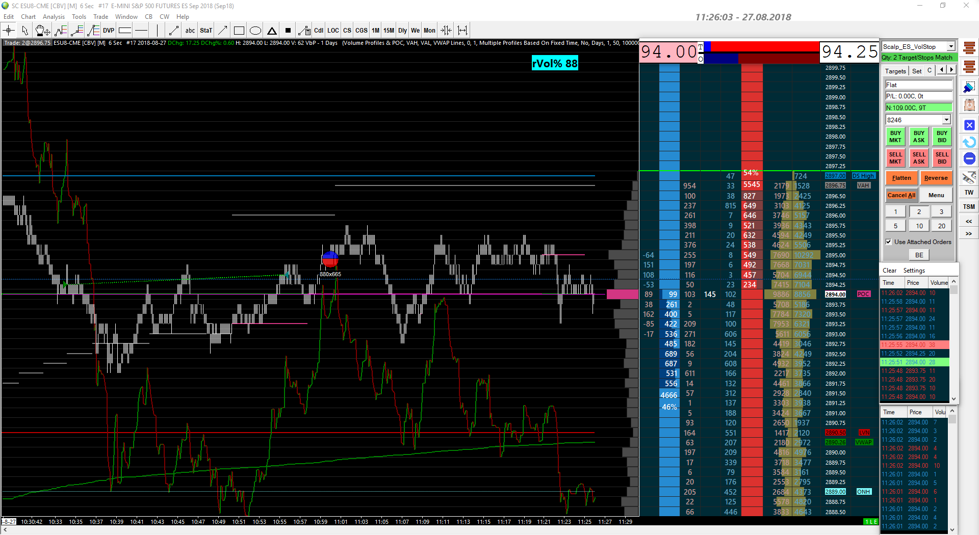

after one of the last prereleases i do not see more than 10 levels of market depth anymore..
i am on a rithmic feed and the data is available and was visible within sierra as well..
please bring them back!
see screenshots.. from aug 17 with 15 levels and from aug 27 with only 10 levels..
trade -> chart dom settings is set to 20

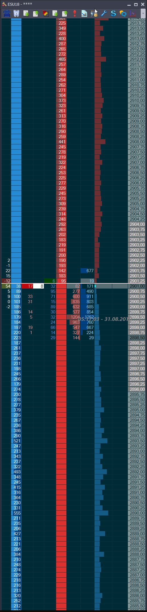

its def an issue with sierra.. i have jigsaw open and am connected to the same feed and it shows all levels (see screenshot)
what i did, though, a few days ago, i changed my trade service to interactivebrokers, connected, disconnected and set it back to rithmic...

From our perspective, that does not prove the issue is with Sierra Chart at all. We do not see how this is even the case. The data comes from the Rithmic API which is simply not providing it.
Anyway we cannot spend any time with this and we will not. We have already looked into it. We will work soon on offering additional levels of market depth through the Sierra Chart Exchange Data Feed.
