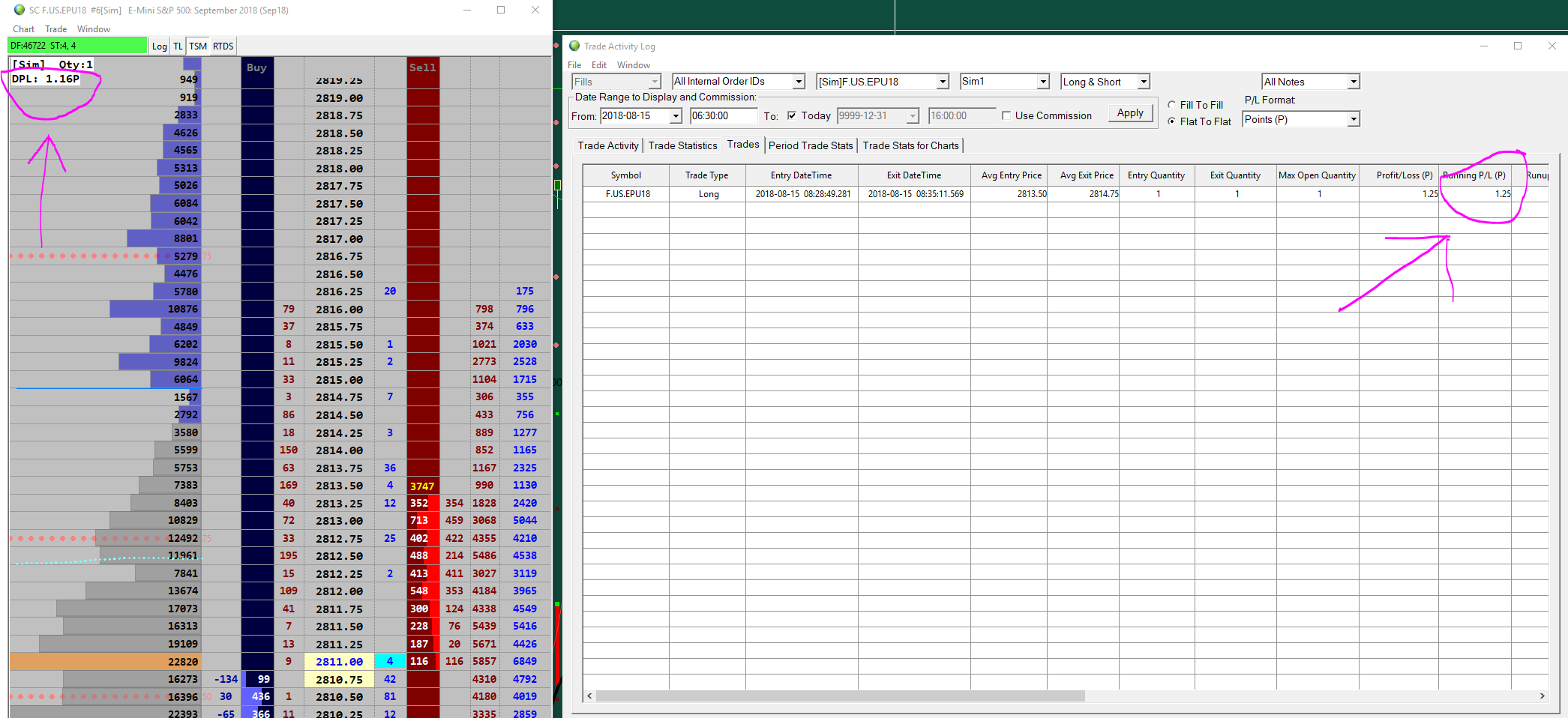

The daily PL data showing on my DOM is not matching the correct info displayed in the Trade Activity Log.
I have already tried clearing the Sim trade data and this does not resolve the issue.
This started to occur when I upgraded to the latest version of Sierra. 1785

I have followed the information on this page but the Daily PL is still showing incorrect on my chart vs. the trade activity screen. Why would this happen ?

Actually thinking about this some more, now that we pay closer attention to the Daily PL in the chart, being that it is an odd value, it might have to do with this new setting:
Chart >> Chart Settings >> Advanced Settings 3 >>Use Symbol Commission Setting in Trade List and Statistics Calculations
That does not exist in the older version. Make sure it is unchecked. So you can see, probably our conclusion that there is some other explanation most likely is correct.
Date Time Of Last Edit: 2018-08-30 06:56:09
[2018-08-30 07:30:51]
We have now updated the documentation to explain to not use the Commission setting either on the Trade Activity Log or the chart. We believe that is the reason for the difference.
