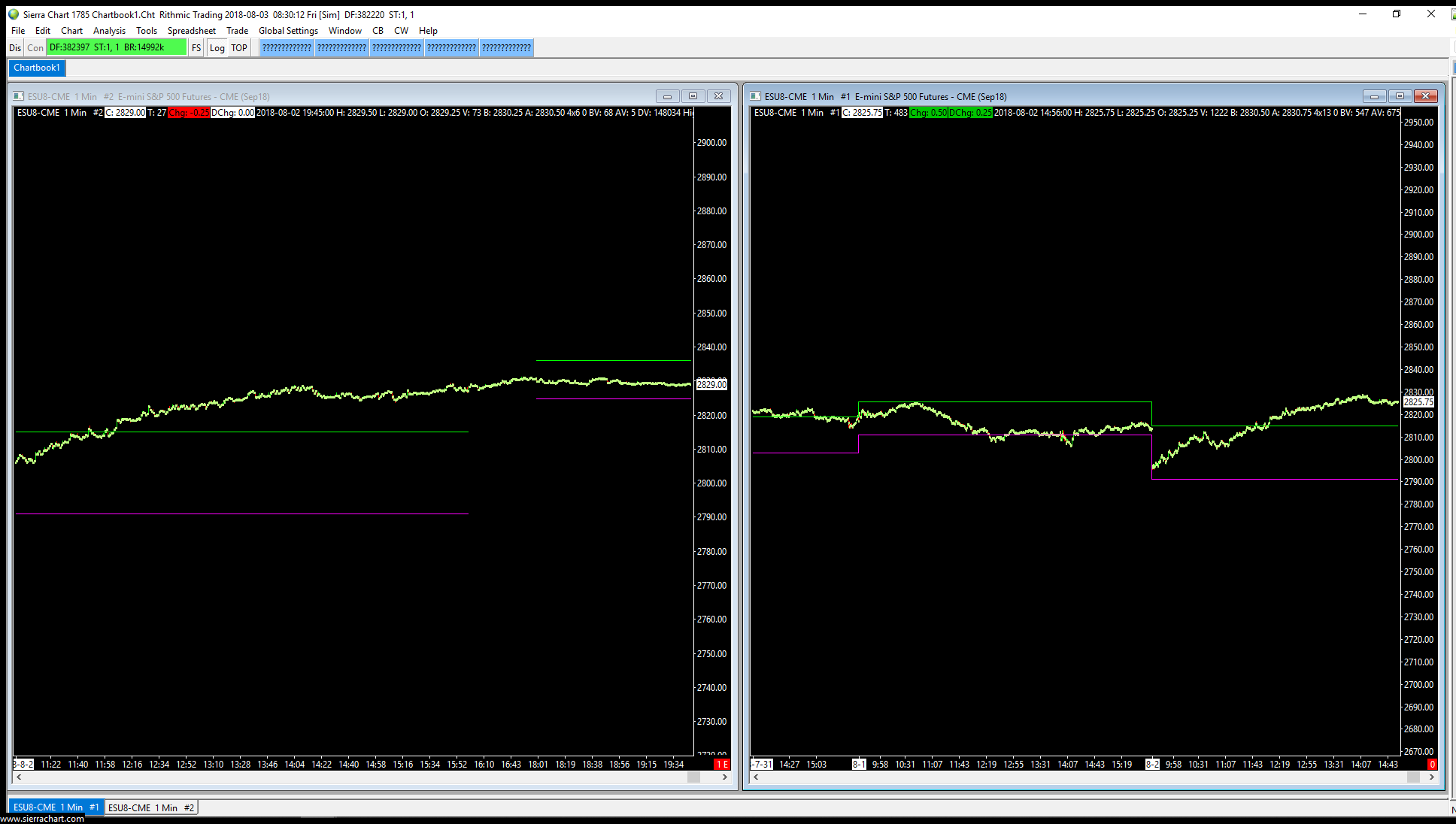

If I understand what you are asking... You are trying to get the Overnight High Low to display from one chart to another chart that is NOT showing the overnight session.
Is this what you are trying to accomplish?
http://www.sierrachart.com/image.php?Image=1533299413788.png
The first chart (on the left) is the eMini S&P 500 1 minute with Use Evening Session checked
The study is High/Low for Time Period - Extended Study
Start time 18:00:00
End Time 09:29:59
Number of Days to calculate 120
Use Stop Line NO
Line Stop Time 15:59:59
Display High Low Incrementally NO
Input Data High High
Input Data Low Low
Friday Evening Extends into Sunday NO
The second chart (on the right) is the eMini S&P 500 1 minute with Use Evening Session NOT checked
The Study is Study/Price Overlay
The only input I set was Study to Overlay
I set that to ESU8-CME 1 Min #1 (The first chart)
and High/Low for time period extended (The study)
I think you can see the High Low for the evening session on the first chart are extended through the day session
The second chart has those High Low lines displayed even though the chart is set to NOT use the evening session
